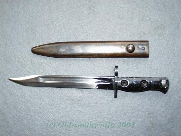

    SLR bayonets shows examples of the various versions

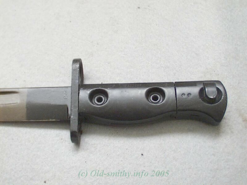

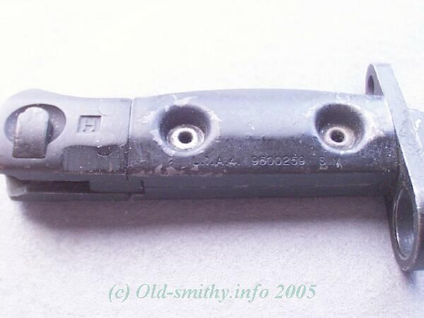

    old-smithy's Avatar
    10-16-2017 @ 07:26 AM
    Houston Texas
    68
    481
    07-06-2025
    06:11 PM
    L1A4
    Essentially the L1A3 with a riveted rather than brazed tang, not produced till after 1970
    My examples are all stores marked with NATO numbers
    The rivets are clearly visible on the pommel
    No rivets in A3
    A3 converted from the A1, note the waisted cross guard the A3 new made are all straight sided
    Last edited by old-smithy; 03-14-2009 at 08:14 AM. Reason: added A3 and description
