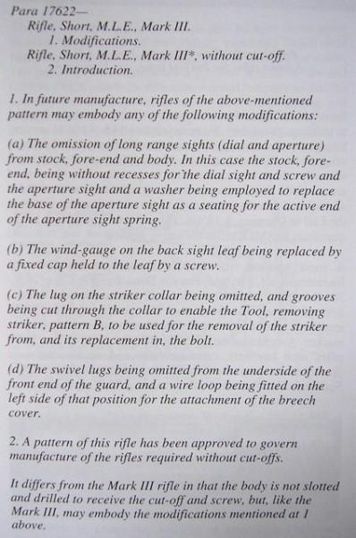

    I was just referring to the fact that the Mk3 had progressed to the Mk3* officially in January 1916 (2nd, I think - speaking from memory here, but no doubt somebody can quote the LoC verbatim), so from then onwards the SMLE Mk3* was the latest current pattern service arm, yet newly manufactured Mk3 rifles are regularly encountered from after this date; some are post WW1 retro conversions, but not all.
    The Loc of 1916 introduced in part 1 changes to the future manufacture of the MkIII
    Part 2 introduced the MkIII*
    The MkIII* evolved from the MkIII not the MkIII evolved into the MkIII*
    The omission of the Volley sights etc were all changes applied to the MkIII but as the MkIII* was the same as a MkIII (but with out the cutoff) the changes applied to it as well.

    Thanks for the quote & the clarification. Perhaps then we should be surprised that there are not more late WW1 Mk3 rifles about?
