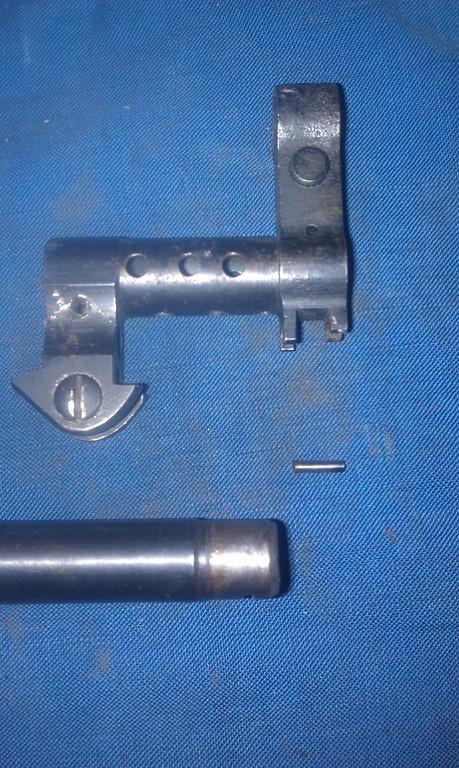

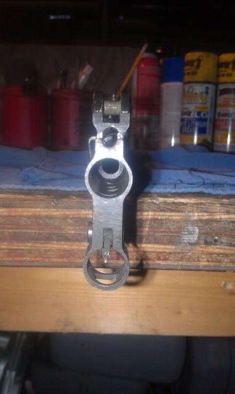

    So the saga continues:
    Got the sight assembly off with some PB Blaster and some heat
    slight step on the barrel to limit sight assembly, barrel end chamfered ( no crown) , and bluing consistent even to the muzzle

    I feel the barrel was chopped .
    if I had a latte and welding equipment, I would make it into a para . not easy to find a replacement front sight assembly so I would try to salvage it by filling in the holes.
    yes, the top cover is a norinco top cover but that's still doesn't mean that much.

    Hi if you will measure the end of the sight inside and measure the the distance on the barrel I believe you will see that they match. at least it looks like it hasn't been cut by where the pin slot is located from the end of the barrel you can find a new sight end on ebay and other places. have a good day
