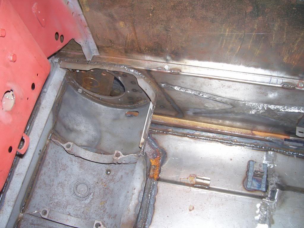

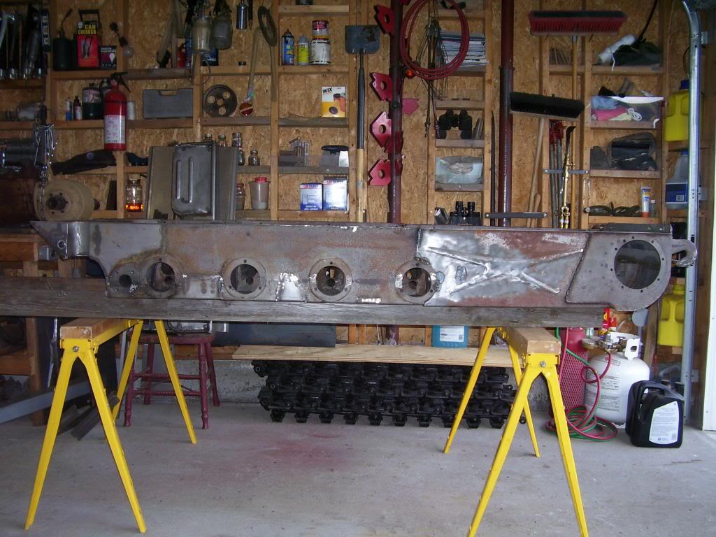

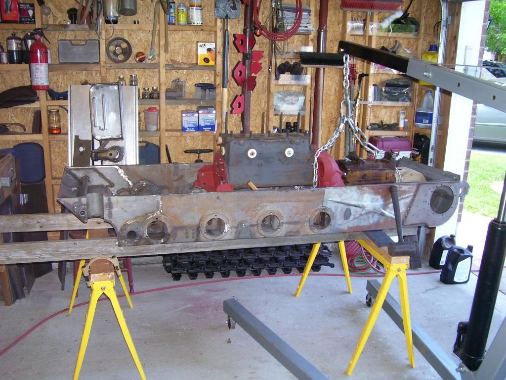

    Rehabilatating the lower rear section
    So much ground to cover I had better pick up the posting pace otherwise this could drag on forever. The issues with the lower rear half where 1. the floor, with its unique square pressed portions needed heavy repair 2. the four inverted U shaped torsion bar houses all needed faberication and repair and 3. about 20 inches of the rear lower had simply rusted away to nothingness. This picture, while previously posted shows the rear end at Day One.
    Another previously posted pic showing the floor sections that need repair. Note the series of three holes punched in the body to drain the hull, Euro Bubba strikes again.

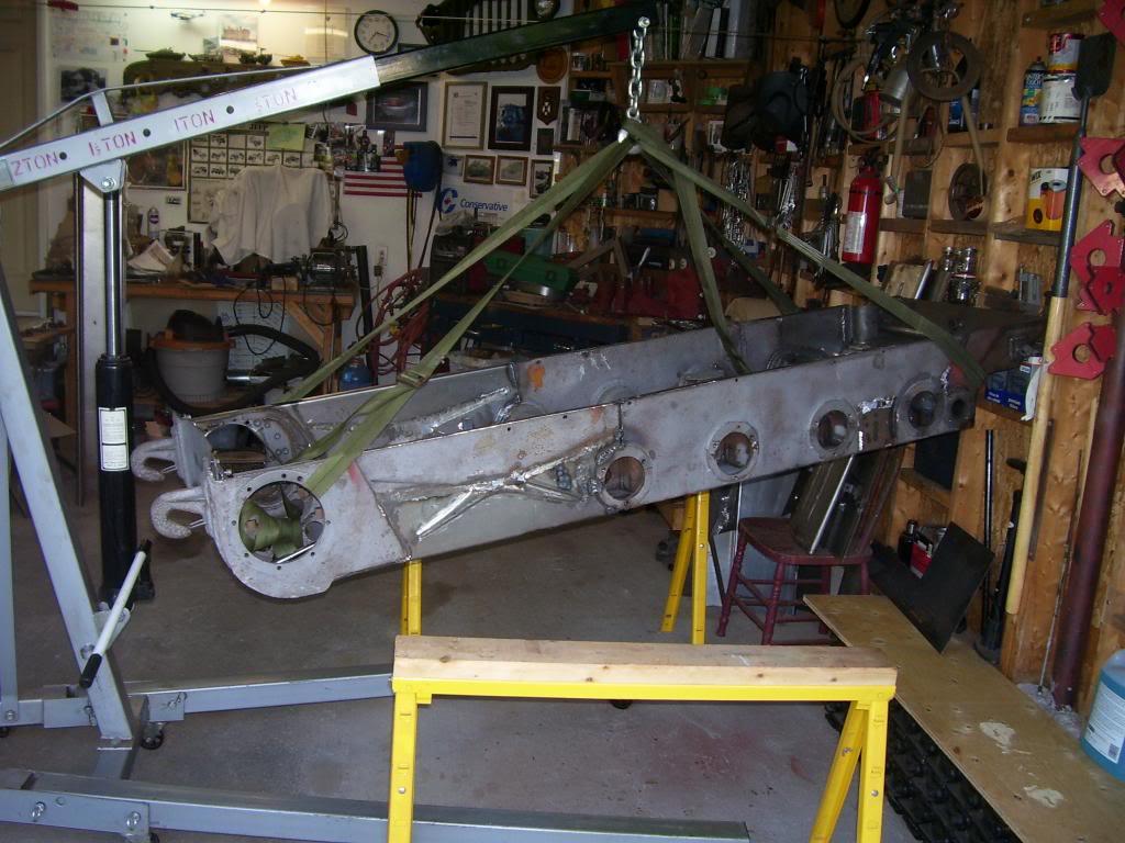

    After sandblasting and final chopping out of rusted areas I now see what all floor wise has to be replaced, plus sections of the sides to extend rearward past the track adjusters. The rear most, and insanely difficult to repair torsion bar house is out at this stage, the first three torsion bar houses where repaired without removing, that back one was just to far gone to do that installed.
    Lower rear floor and side sections fabericated. I had to resort to hotgluing chunks of rust together to get the radius of the side sections where the Kett muffler mounts off the residue to make new panels.
    Repairing #4 torsion bar house.
    To repair #4 it took 22 individual pieces fitted and welded into repair, then it had to mocked up with the carriers and torsion bars installed so the vehicle geometry was correct. I spent more time on and effort on that rear house then the other three.
    Cut and welding what felt like forever, one one part (good old #4).
    Repairing houses without removing, section of mocked in floor to give correct profile.
    New made rear floor installed and next is replacing #4 house.
    Ready to weld in #4 house rear metal werk largely done after about a couple thousand test fits I get the new to fit nicely with the old and weld together.
    #4 back in, finally.
    Done.

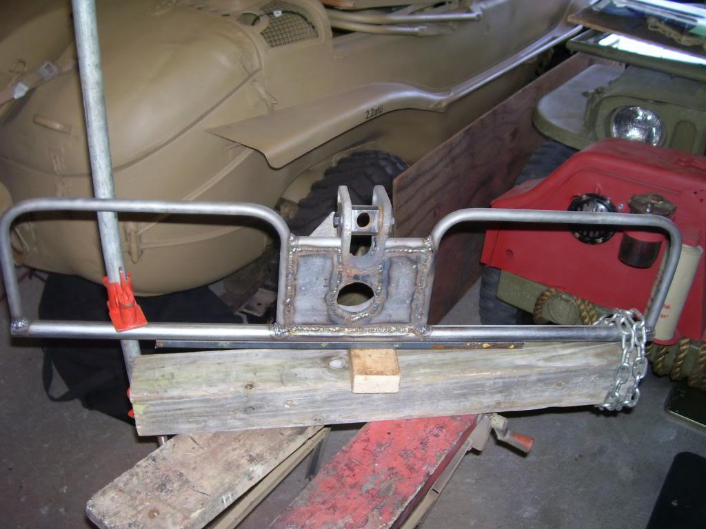

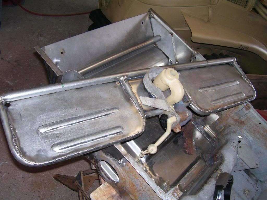

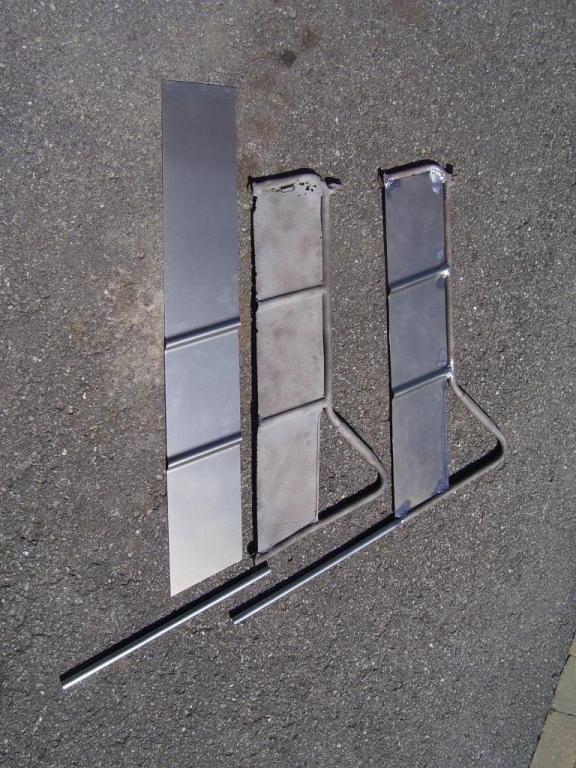

    The Rear Foot Rest

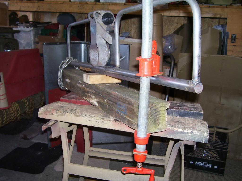

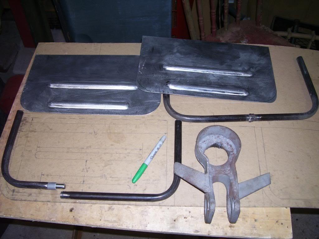

    When the kett came to me it had a jumble of "crap" tossed inside the body. In with it was the remains of the rear foot rest and more importantly the heavy formed section of the foot rest for the trailer towing hook. Using the residue of rusted footrest I pulled whatever details I could off them (not much was forthcoming) and using measurements off the CWM kett and looking at a lot of pictures had new sheet metal sections made by Pagen industries in Stitsville, Pagen did most of of my metal braking and put up with all my fussyness to detail.
    Starting to put things back together. No doubt trained welders will find fault with my welding, its perfectly in line with the crappy work done with slave labour during wartime conditions. I have saved a few choice examples of original werk done. Every kett owner I talk to says the same thing about welds, holes blasted in sheet metal, splatter everywhere, etc. Note my "high tech" restoration facility (two car garage with three jammed into it)
    Trying to keep things straight.
    Sheet metal installed, test fit of kett tow hook, old center piece installed on all new metal.

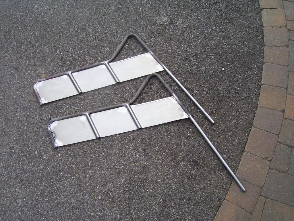

    While I am at it here are the rear hand hold frames and sheet metal. I believe in saving as much "Kettenkrad DNA" as possible so I cut out the rusted sheet metal, tweeked out a bunch of bends and twists, and using new steel formed with the correct profile by Pagen I saved the pipe like frames and grafted in new sheet metal.
    New pipe welded on the bottoms, gotta save as much as possible.

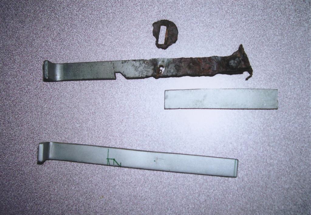

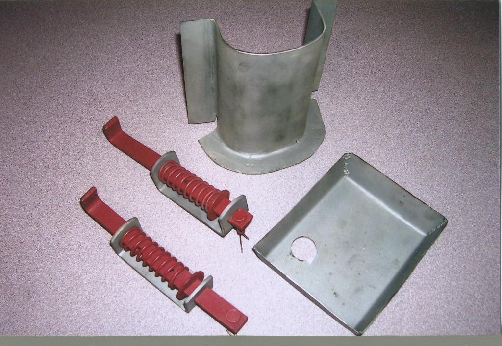

    The restoration also called on making lots of small things that had rotted away over the decades. Here are the handles for the body drains being made, one totally new, and the other I cut off the top "savable" section and welded on new bottom to refurb.
    More small details, the D shaped part where the exhaust passes out of the inner body to the muffler, the little tray like thing for when engine oils is drained (I even copied the pattern of original spot welds when I reinstalled the new tray) and the finished latches/handles for the body drains.

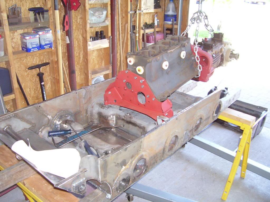

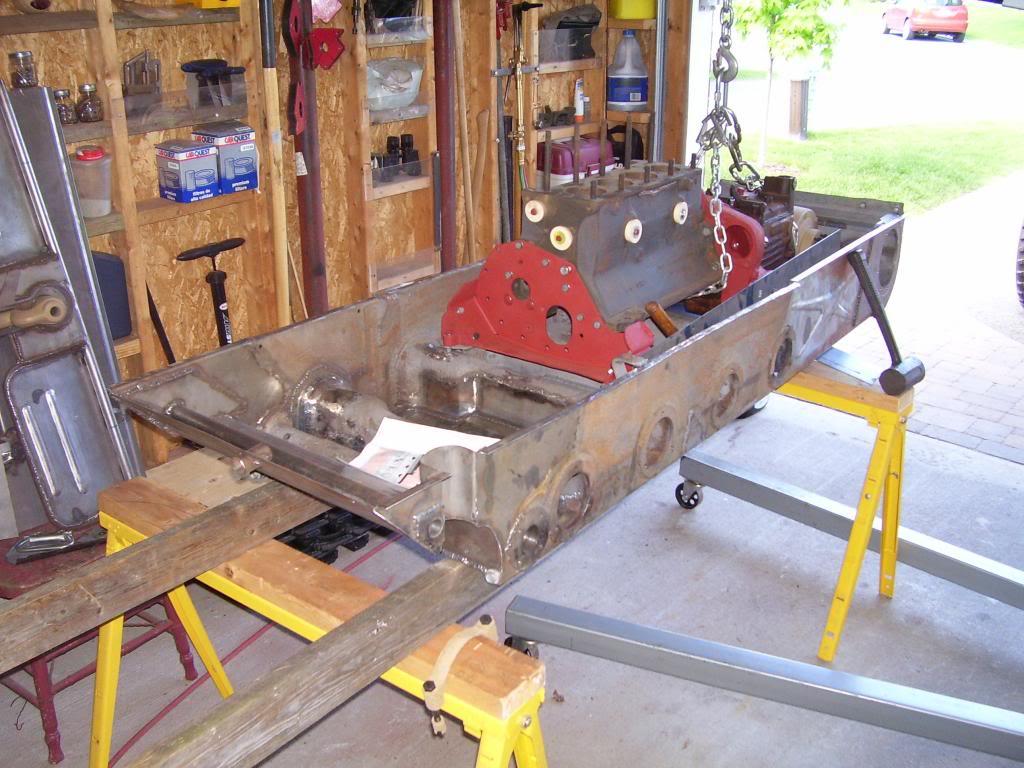

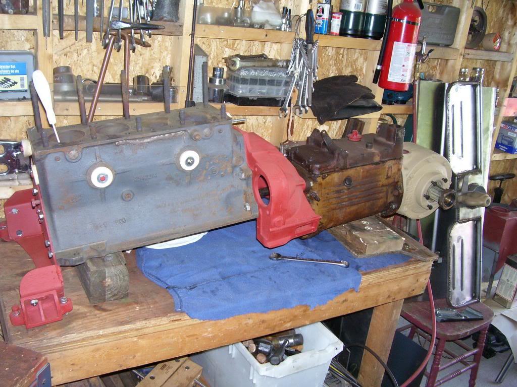

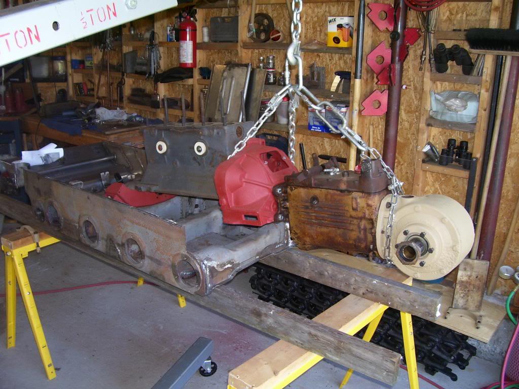

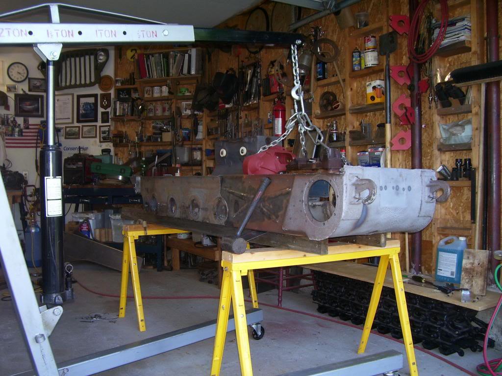

    Mating the lower front and rear portions together
    Two Victoria Days ago I had the front and rear portions completed and ready to be joined together again. The first pic shows the inside of the front portion new made floor and all the various fitting for seat mounts, drains and the inside laminated skin, plus the fitting for the steering brakes and final drive covers.
    To totally ensure I get the fit, lengths and geometry of the vehicle right I bolted the drive train back together and used that as the jig to get it right, the first time. On the rear body portion is the diamond shaped engine mounts and on the front portion are cresent shaped differential mounts as long as everything fits in I have about 1/2in adjustment I could work with.
    The first of about 50 test fits, a whole day was spent test fitting trim off replacing and removing drivetrain, etc. Note on the side of the engine block you can just see the cast date of 1 D44
    Test fits galore.
    Starting to come together around lunch time.
    DONE ! tons of finish welds to do but front and rear are now one unit again.
    And now the real work will start in earnest. Next up will be the reconstruct of the upper half of the body (and what felt like a couple thousand other things to attend to). Note the stack of restored kettenkrad track layed out in groups of ten, which is about all one can carry with getting a hernia.
    That day was what I consider a big day in the restoration because it means my ideas on putting ol rusty back together where working out. More nasty suprises where in store but at this point I was feeling pretty good about things.
