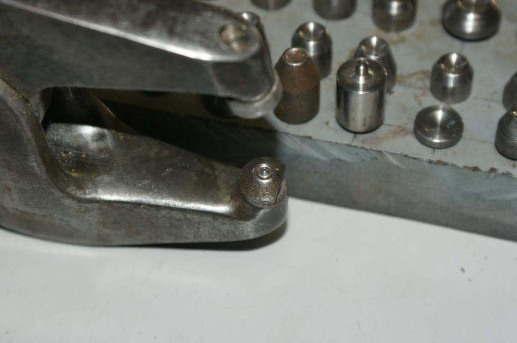

    can you make a tool like the vickers belt repair tool that looks like pliers. this will give you more control and you can still place the bottom jaw on the vise and hit the top jaw to help get the set pressure

    Perhaps modify a large pair of vise grips? I could make the tips from a punch or old 3/8 extension maybe and then weld them onto the vise grip. I'll try this first, if it flops that is up next. Thanks!

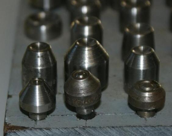

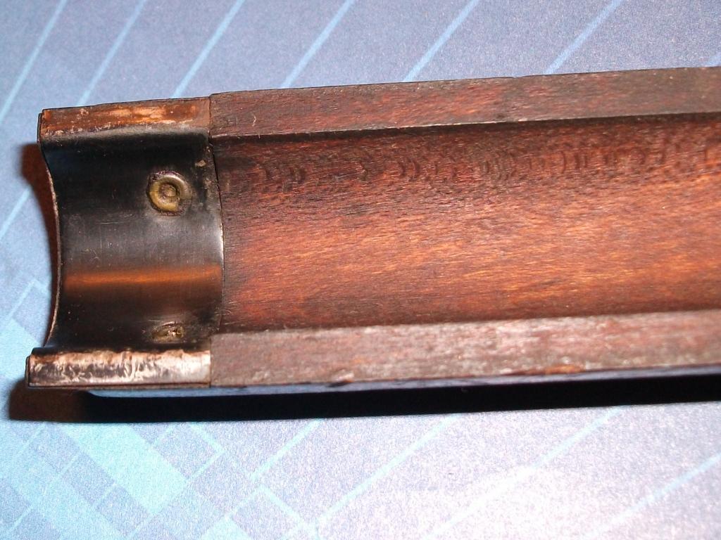

    Not the same handguard , but similar rivets (I think!), tail side showing:
    Tubular rivets generally need specialized forming tools for both head and tail. (Actually "semi-tubular" as only the tails are hollow. I used my tubular rivet squeezer sets for WWII aircraft work, mostly control surface buildups. But they also have applications still in furniture/light structure (i.e. tent frames, lawn chairs.) work. Also big ones used for holster snaps, etc.
    Not too easy to make properly on your own. Generally best to buy and then modify to fit the particular job.
    The left squeezer set would be about the right size for handguards, but probably would need the OD turned down to fit the recess in the wood.
    The upside is that the fancy pneumatic squeezer isn't required. Can make do with simple hand tools adapted to the forming tools (i.e., the "squeezer sets") for flaring the tail.
    Finding non-nickel plated rivets could be "fun"! Plus, they're length specific.

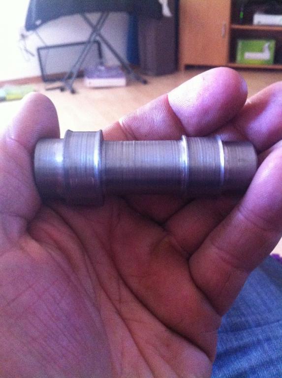

    When rivetting a balance staff, we use two convex punches and a flat one. The two convex punches spread the rivet(two different sized punches). The flat punch flattens it so the hairspring collet lays flat on top of it. Couldn't you do the same thing?
    Attachment 52161Attachment 52162

    Gsimmons, I think I may wind up having to do something like that. The problem is that the rivets have a nice round head and solid shank. Trying to hold both tools, the guard and spring plus hit the whole works with a hammer is one tough juggle. Was thinking about building the tool with the *** to put in the hole in the mandrel but that's going to be a bit of a fight as well because it has to be a pretty precise affair, the rivet shank is only .092" diameter. Time for more thinking before moving ahead...
