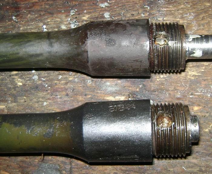

    the way I intended to do the headspace etc. is to trim down the extension untill the bolt closed firmly on it then with the chamber reamed and the rim recess cut it will be OK.
    I am doing 3 rifles at the same time and dont have any spare bolt bodies or heads so I am going to make them work with the parts that they came with.
    I hit a road block yesterday when I went to put the liners in. the liners were sold as 5/16" OD and I drilled the barrels to 5/16 (.3125) but the liners dont fit because they are 8mm (.3150) so I have ordered an 8mm reamer that should be here by friday. so while I wait for that I will start converting the bolt heads and making extractors.

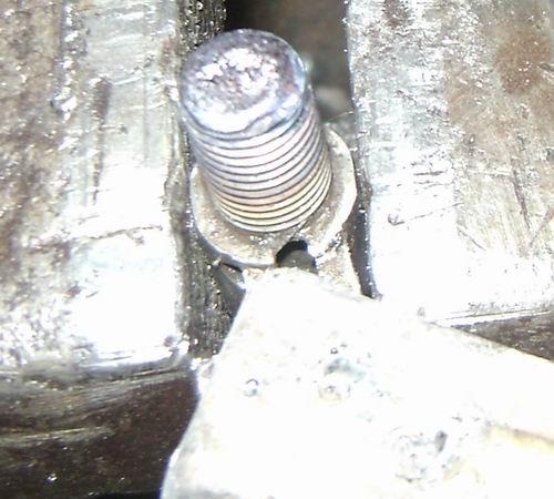

    welding up the bolt head. I made an insert that fills the void where the firing pin goes and welded it in place.

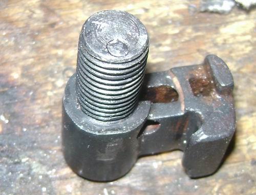

    back end machined off and drilled for firing pin

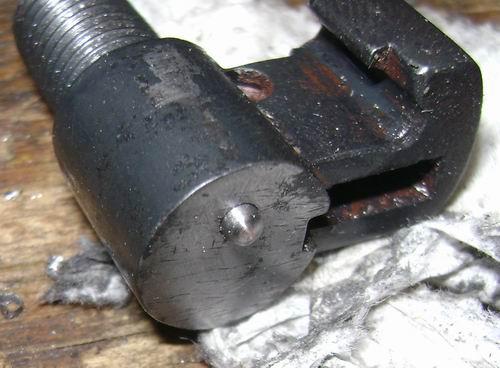

    bolt face with finished firing pin
