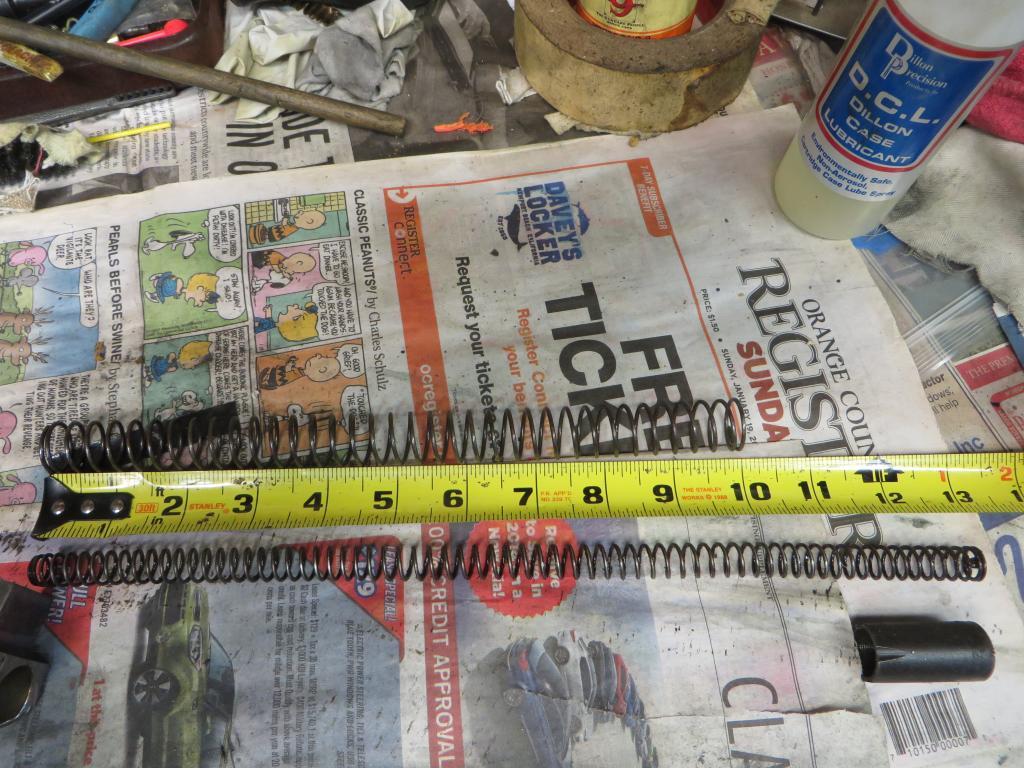

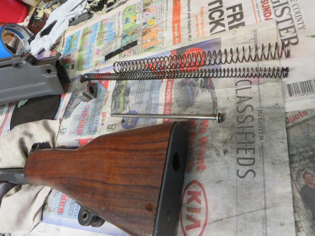

    OK - here is what I have. (see what happens when you get a rifle w/o a manual). Just realized that I DO have a return spring in the stock as well as the striker spring. However - both seem very week as setting the gas port to anything but the lightest setting will cause the bolt group to SLAM into the stock. Plus I'm still crushing the striker spring. There was relatively little force as I unscrewed the cap at the end of the stock behind the return spring. Is this supposed to be a strong spring?
    Take a look and tell me what you think

    Taking into account what Bruce says in thread 22 above, it's little wonder that the breech block and piston/piston extension assembly (BB&PEA) opf your semi-auto hit the buffers like a run-away train! The actual gas operation of the gun still works as per the auto gun and as such still NEEDS the double return springs. This is JUST the reason why we put doubles in there in the first place. Jeeeees...., words fail me......... Each return springs should be 13.4" long (neutral) as on the rearward stroke they operate as a) buffers to cushion the violent rearwards action of the relatively heavy BB&PEA and B) store energy to act as the medium to retuyrn same to battery AND cock, feed, load and lock the gun.
    Haven't got the EMER handy but bearing in mind sentence 2 in para 1 above, 'action weight' of the gun must still be as per original. That is (if I remember correctly so anyone with the EMER handy please feel free to correct me.....) 19 - 23 lbs weight that goes down to 16 - 23 at a unit level.
    GET THE CORRECT SPRINGS PDQ and your prayers willo be answered!

    djandj, did you pull the spring off the guide? It should be held together. As Peter said, just buy another Mk2 spring set.
    I've also just noticed something which looks odd. Which spring have you got as the original return spring, and which is the striker spring? Looking at the setup of the striker on the slide in an earlier photo, it appears you have the longer and smaller diameter spring as the striker spring and the short fat spring as the return spring. Is that correct? If so, it's back to front.

    OK Gang next question. As you can see, my Len Savage Bren came with the 3/4" striker spring located over the thin guide rod AND a mainspring which is located in the stock BEHIND the guide rod. NOW. I have received the new old stock MKII double springs (very small one inside a bit larger one (about 1/2 in diameter) SO.... I ASSUME I replace the 3/4 inch striker spring that the gun came with (right?) Do I leave the two new springs one inside the other as they came? and do I also replace the mainspring behind the guide rod in the stock?
    Also, I wonder about changing to the real Bren springs now as it was pointed out above - the buffer block was drilled out to accept the 3/4 in spring Len originally sent with the gun. What happens when I change to the smaller 1/2 spring?

    The double spring goes in the butt and replaces your single return spring. Leave the striker spring as is for now.
    The return springs should fit onto the guide so that you can hole the end of the spring and the guide will sit on the end as one complete item. I can't find a photo to show you.
