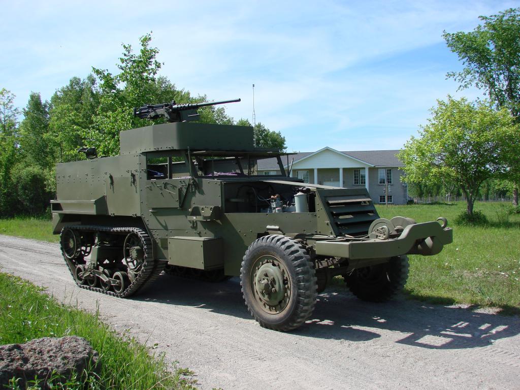

    Thats an m3 in your pic. All m2 and M2A1s did not have the door, but the M9 which was the M2 version made by IHC did come with the door but they were not USAicon used, all made for allies and have many differences from the white motors halftrack. The M4 and M4A1 is a derivative of the M2 halftracks, and did have the door. Mine was an M4A1 out of the factory, but all was missing and M2A1 was the logical build
    Quote Originally Posted by Gil Boyd View Post
    Andy,
    It does look like it came with a door at the back like most were manufactured to that standard or is it the slight and light of the camera angle?
    Image attached shows rear door, but there were those that had fixed tail gates when A/A guns or Mortars were fitted inside the compartment or indeed heavier guns
    ---------- Post added at 10:23 PM ---------- Previous post was at 10:18 PM ----------
    The M21 was based on the M3 chassis, the M4s were on the M2 chassis. Also, apart from some small add ons to the updated A1s, they added a steel structure under the mortar pad and had provisions to fire forward and rearward. The m4 and M21 original production didn't have the floor brace and the floors were buckling. Also they were not designed to fire forward, but troops did anyway

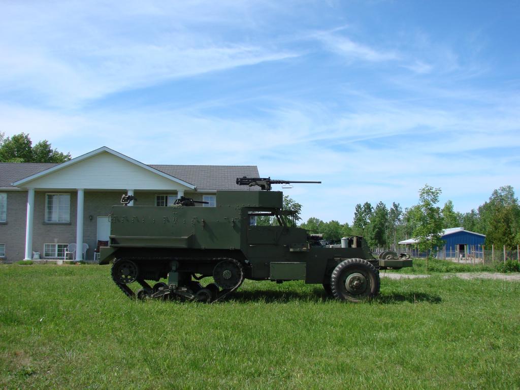

    Since today was the 70th anniversary of D-day, the last few days I was getting her ready for her first drive today. Sooooooo here it is, the first drive under her own power.

    Your poor neighbor Andy!!... You just made his John Deere lawn tractor look like a matchbox toy...You win!!...

    Andy,
    Great achievement and now priceless

    Fantastic job bringing life back into that old war horse!!!!!
