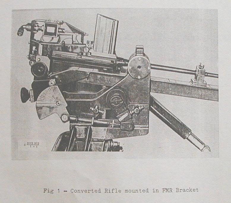

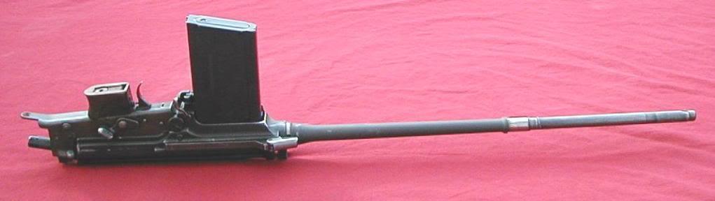

    While were looking at some unusual training aids, here's another that I'm looking for the 'bracket' for.

    I assume that this is in .22" for mounting on the exterior of an Anti-Tank Gun. Or Tank main Armament. For interior 30 Mtr Range practice?

    Definately a .22 by the absence of the gas block and return spring tube. Also the cut-off pistol grip thinggy. I would say that it was to replicate the or fit into the M8C rifle mount on top of the wombat. It wouldn't sit inside the main armament barrel as the mag would foul the chamber.
    All this sub-calibre training and electronic laser simulation - they were just starting to do simulation training with hand grenades too - is really no substitute for the real McCoy

    As you say an indoor substitute for the .5 on the Wombat

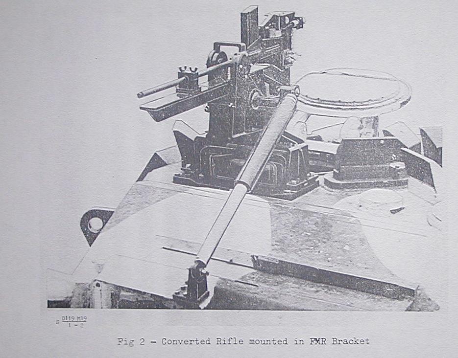

    Its the sub-cal unit for the CRV(T) Scorpion as per the EMER D119, Misc Instr No. 19, Iss 1, Mar 73; RIFLE 7.62 MM L1A1, Technical Handbook - Miscellaneous Instruction - Conversion of rifle for use on CIM's and gunnery training turrets.

    Yes Peter, and still dons the zip as a pull, on my original PARA smock.
    Great Pics there Kiwi

    Yep, makes sense and when I look, there it is in my EMER copy!
    It's even stranger because at one time we had a load of Australianicon made .22" semi auto sportco rifles designated the L19 as I seem to remember. They did the same sub-cal job in our Centurion gun tanks. The L19's were stripped of all the superflous crap and fired down the main 105mm gun barrel at solid rubber tanks.
    The 'target' tanks at 25yds away were made from very hard compressed rubber and lasted a fair while. But when you hit them they just sat there. BEST was to hit the sand just below them which sent them flying. In much the same way as the Iraqi T72 turrets did in Gulf1
    The sportco's....... yes....... Even though they had no woodwork the sights were still on them. So whenever a Centurion was taken out across Salisbury Plain for a REME track-test (after a new set of tracks was fitted), the commander would take a sportco and take pot-shots at the zillions of peasants that littered Salisbury Plain. Did I say peasants......... I meant Pheasants as we didn't have too many illegal immigrants then!
