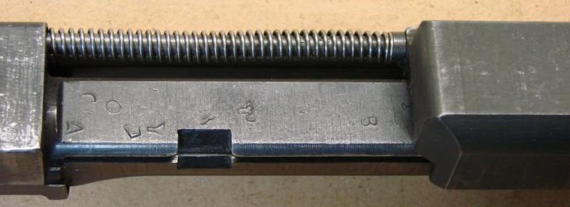

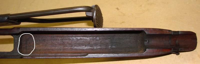

    If it was there, it would be stamped in the circled area.

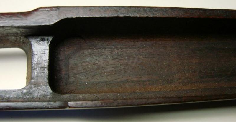

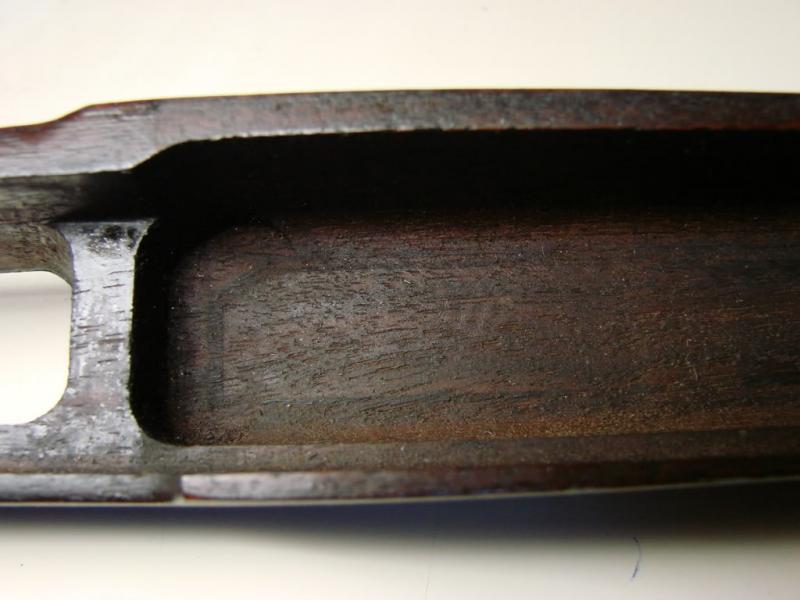

    Is there a faint outline of an “O” in the lower left corner of the slide well photos?
    It surely is not very clear.
    I had to take many photos of the small “crossed cannons” escutcheon on the underside of the pistol grip showing the “O” before I got something that was “somewhat” clear…..these markings are pretty faint.
    The “I” is obscured by the sling attachment assembly.

    I see the OI and cross cannons on the bottom of the pistol grip. It's not unusual for the early first production M1A1s to not have the OI in the slide well.

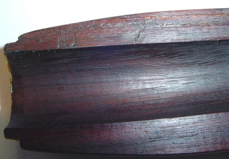

    “P” proof code in a circle on the rear of the stock above the pistol grip by the recoil plate.
    On the underside of the pistol grip there is a stamped faint Ordnance ”crossed cannons” escutcheon with what looks like an “O” for Overton /Inland. The “I” is obscured by the sling assembly.
    There is a visible “OI” stamp on the underside of the handguard

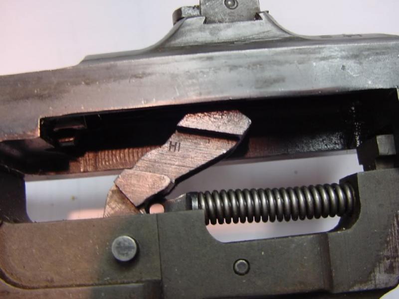

    Hammer marking; “HI” Inland code.
