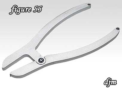

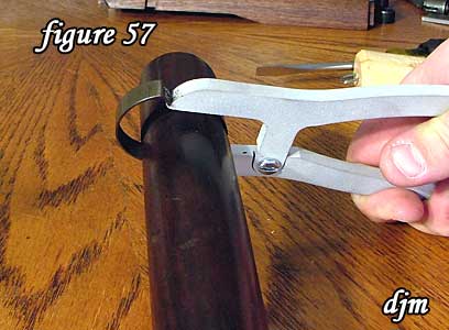

    Anyone use one of these?
    Pic from surplusrifle.com
    Badger Ordinance Handguard Clip Pliers at Brownells
    They look pretty marvy!

    It pays to have a good set of handguard pliers to remove the clip from the handguard. When I use method #2 to remove the handguard from the rifle I use a 1/8" drift pin and a fulcrum against the barrel, padded with a gun cleaning patch against the barrel and a 16 penny nail for the other side with a fulcrum and a gun cleaning patch for padding against the barrel.
