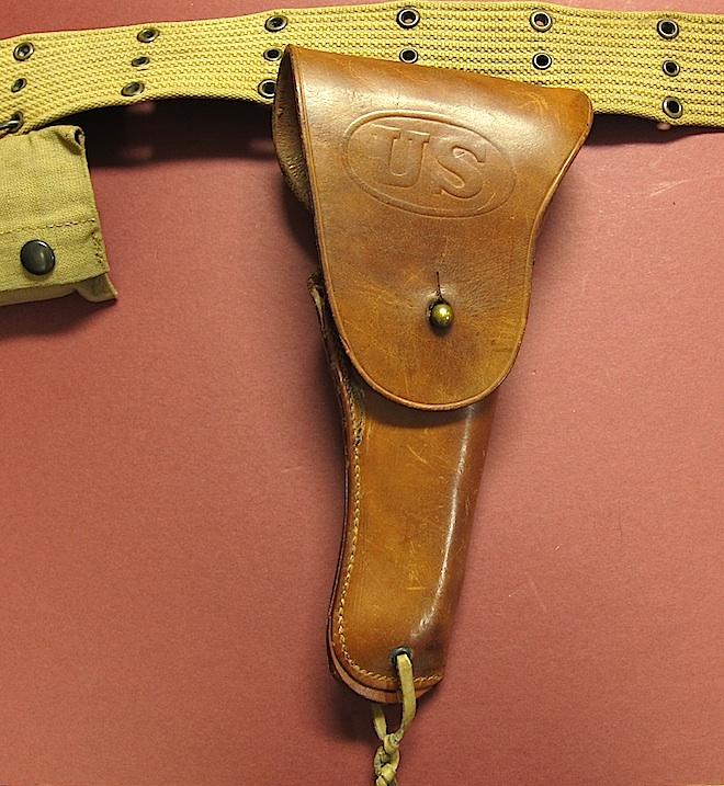

    Harlan,
    This 1918 dated holster has had at least two treatments of Pecards for the past 15 years, and is better now than when I received it. Apply in thin even coats, and it soaks in with no oily feel.
    If you are going to use Ballistol on leather, use Baby Oil instead as both are mineral oil based, but the Baby Oil is pure without the bore cleaners.
