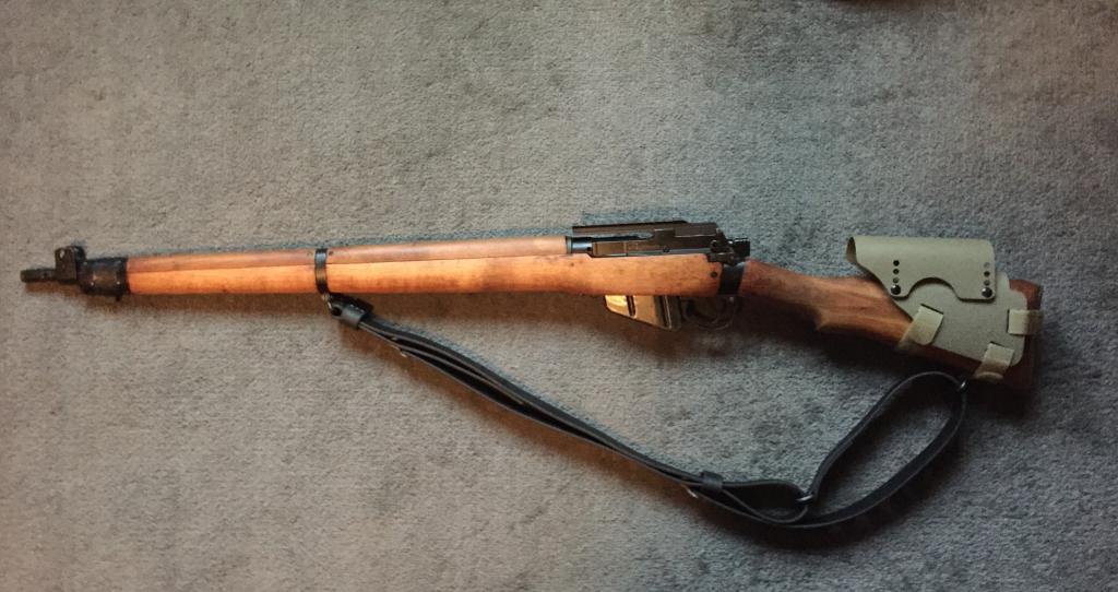

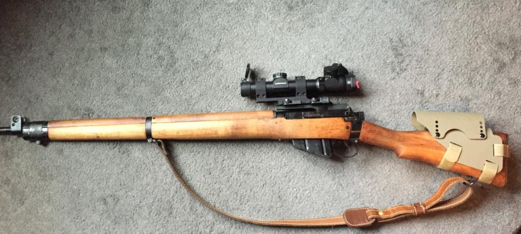

    Just test fitting a LaRue Tactical mount from my AR:
    Turner Sling upgrade:
