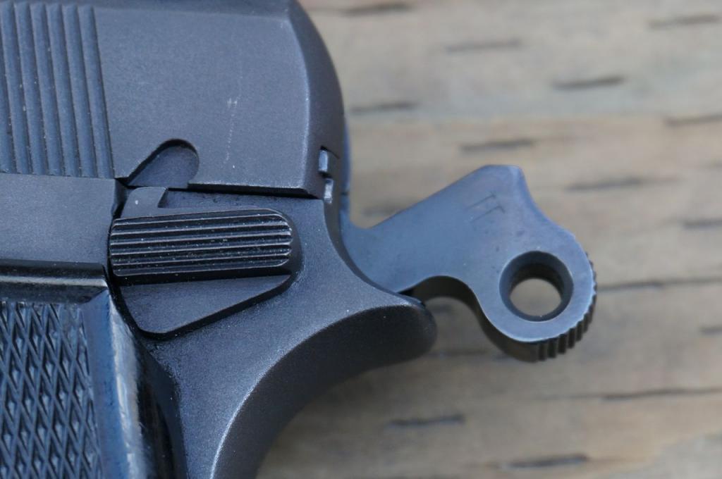

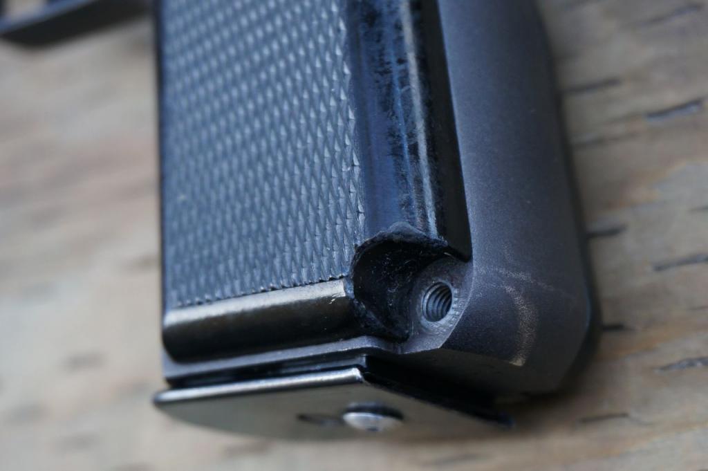

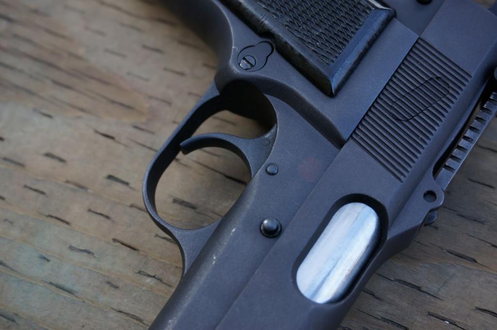

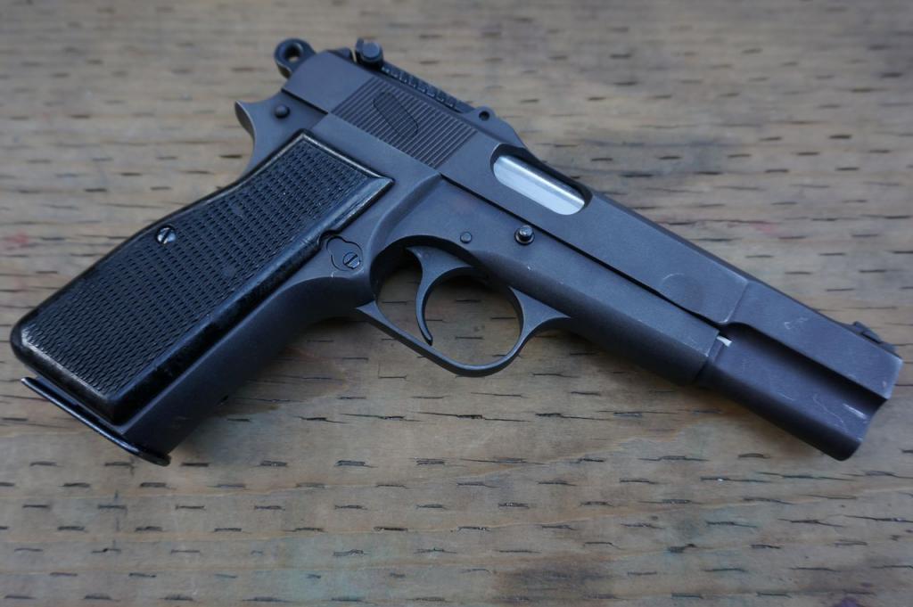

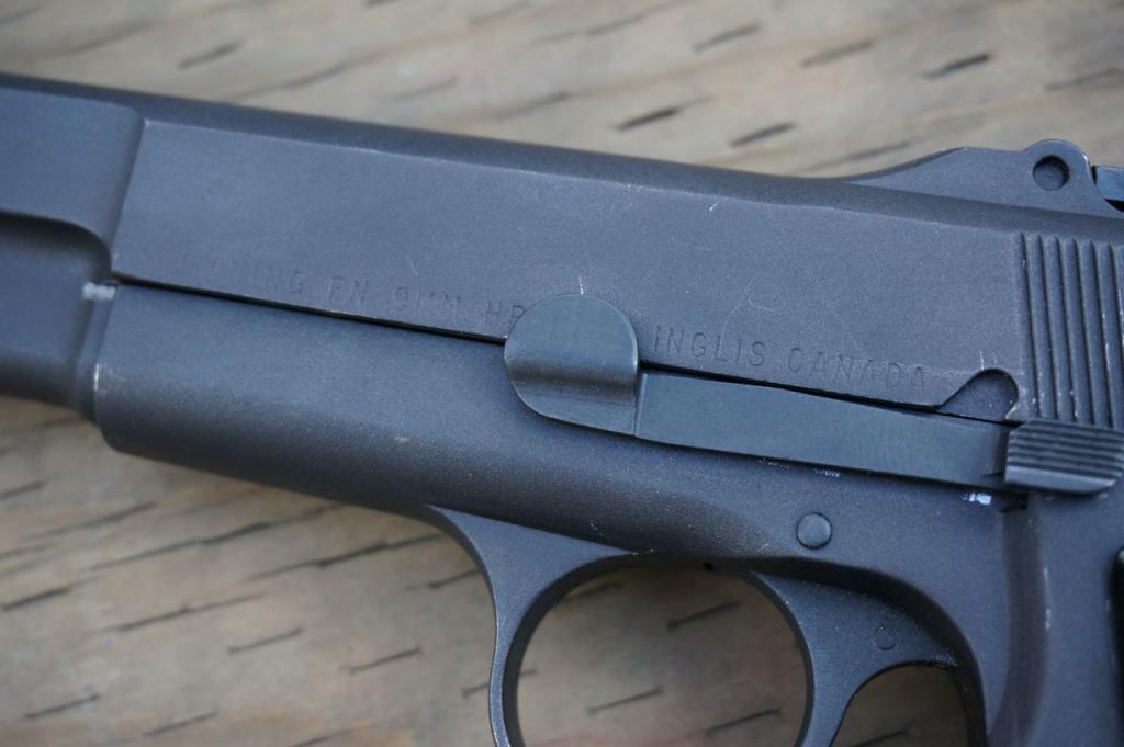

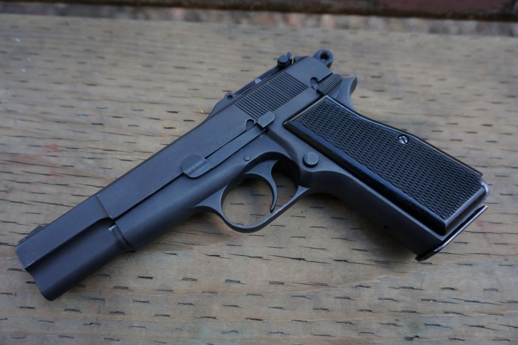

    Quote Originally Posted by Paul S. View Post
    A few observations:
    1. there should be, but aren't, Dominion of Canadaicon acceptance marks (a broad arrow inside a "C") on the right side (S/N side) of the frame;The C^ is there Top left of frame close to magwell swell, but the DCP isn't
    2. there should be, but isn't, a cross pennant marking of the barrel visible through the ejection port;
    3. the factory applied serial numbers were done using a pantograph which left very neat, evenly space, all on one plane, consistent-depth markings while your serial number is uneven, off-line and not consistent;
    4. there is no marking above the "BROWNING - FN 9MM HP" where the "MkI*", etc. stamping should be;This is an EARLY slide (pantograph engraved left side markings and long dust cover edge) and so wouldn't have the MkI or MkI* originally applied
    5. and - significantly (or not) the cam lug is prick-punched to keep it in place in the frame. I noticed this right away as the Inglis BHP was known to have cam lock bars come loose
    All the above, the last point in particular, makes me wonder who, when, and why that was done. One possible answer is also the most likely explanation. That is, as has been suggested earlier, the pistol was made from parts that "grew legs" or were poached from the factory before the S/N was applied and became accountable.
    I'm not a betting man, but if I was, I would take 10 to 1 odds on it being a "Lunch-box Special".
    It is definitely a "lunch box" which escaped without an original serial number.
    I've owned several, from "in the white", mixed finish parts, and completely finished except for serial #.
    The one I have retained is "in the white" composed of parts which are all MkI rather than MkI*. My slide and frame were both grabbed before final finishing operations.

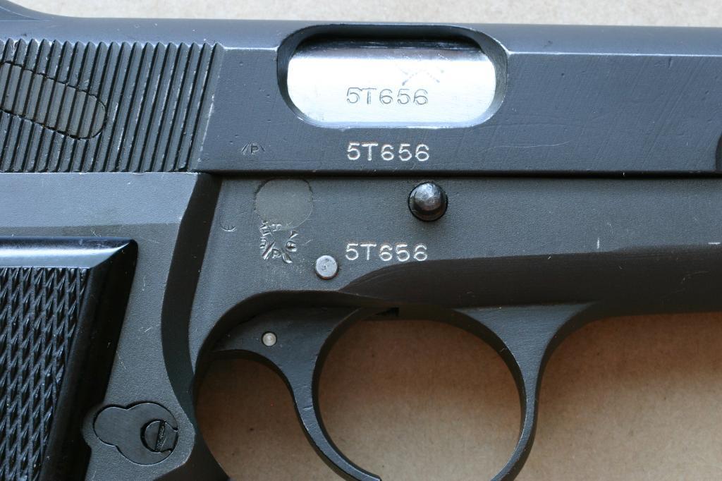

    That is an interesting pistol Horilka.
    Do you know any of its history? I am specifically curious about how and why it was refinished. Was it originally in the white, or were some parts mismatched and then refinished? I have not seen that combination of some polished blued parts (i.e.: grip screws, rear sight, hammer, magazine, etc) and some sandblasted (i.e.: slide & frame) before. I am also curious if the slide was filed to remove serial numbers, perhaps to match a lunch box -unnumbered - frame, since the right side serrations appear to have flat tops rather than sharp edges (or is that just an optical illusion cause by by monitor?).
    Cheers
    TEG
    ps: Here is a picture of my 5T, the serrations appear much sharper and the original tooling marks look rather crude at this magnification:
