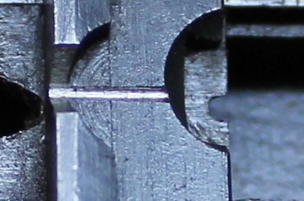

    I have a '03 serial number 1461633 barrel date 7-34 that I just purchased. I have a few 1903 rifles and none of them have a rear sight slide like the one that is on this rifle. There is a line on the slide that under close magnification appears to be filled with platinum or silver. There is no star on the muzzle or a star gauge number stamped on the barrel, so I am assuming that this is just one of the standard 1903 rifles produced in 1934.
    It it some kind of NM sight? I only have three others so I don't have a large personal database to choose from. I was reading about them in Brophy's book but he just mentioned the early sights with the platinum line bisecting the peep sight. The picture was taken right after I got it and before I took the time to clean it up so I apologize for the dirt that is in the line.
    Any information that I could get on it would be greatly appreciated.

    Never seen one exactly like that - I took the liberty of passing the picture along to Joustericon, as well.

    At its lowest possible setting, that rear sight notch with the leaf in the up position would put the shooter on a target at 1400 yards range. I believe that the line is just a scratch put into the bottom of the battle sight notch by somebody who wanted to create a fine groove to sight through on the Battle Sight.

    Seems to be the consensus.

    Maybe something luminous, when shooting in the night in the "battle position"? Or to use it in the same position with a different contoured front sight.

    It is most definitely not a scratch. It is very finely machined and the filler is almost certainly a metal like platinum as there is no tarnish on it. I don't believe it was done by the arsenal, but the quality of the machine work tells me it certainly wasn't done on someones kitchen table.

    Well that IS interesting!

    shooter mod..
    the filled lines iv seen are on the iris of the sight

    Maybe a grenader added it to stand out against shadows in a town type setting.
