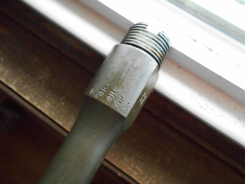

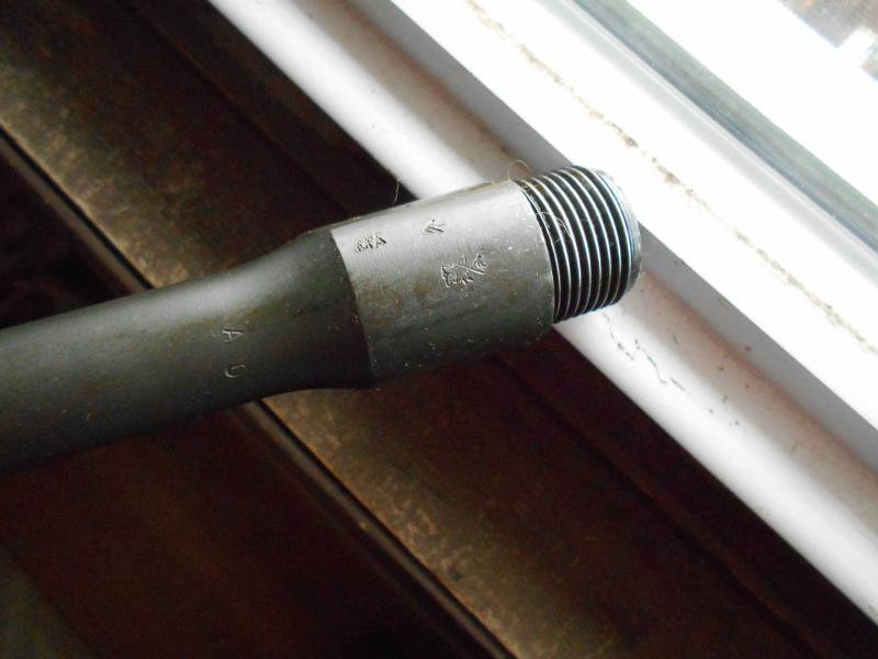

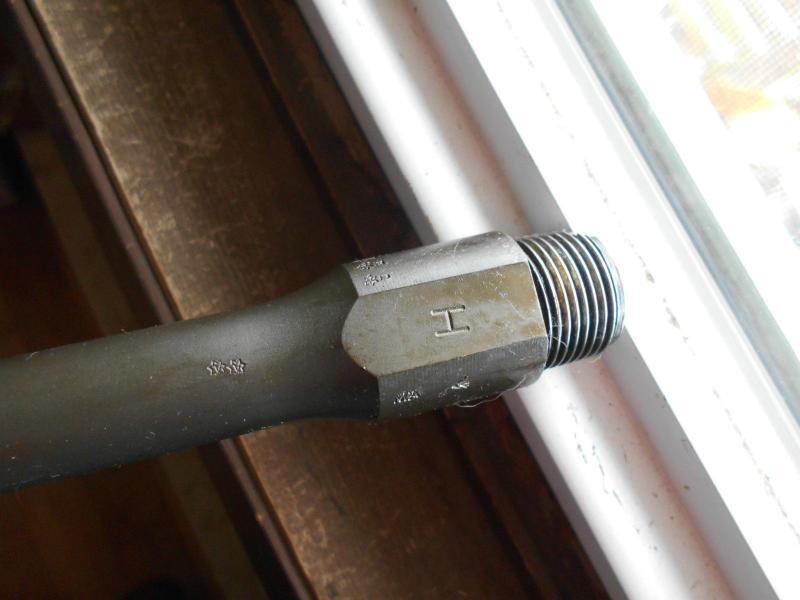

    QUOTE=SpikeDD;323214]A single * in front of knox form or in any other area of the barrel indicates rust near that mark. Two ** on knox form indicates moderate pitting of rifling or throat. There is no reference to two ** on barrel in front of knox form..... Skennertonicon's The Lee Enfield. It may possibly mean badly pitted in the area of those marks?[/QUOTE]
    Armourer's Wing Precis Volume II
    Attachment 59941Attachment 59942Attachment 59943Attachment 59944Attachment 59945Attachment 59946[
