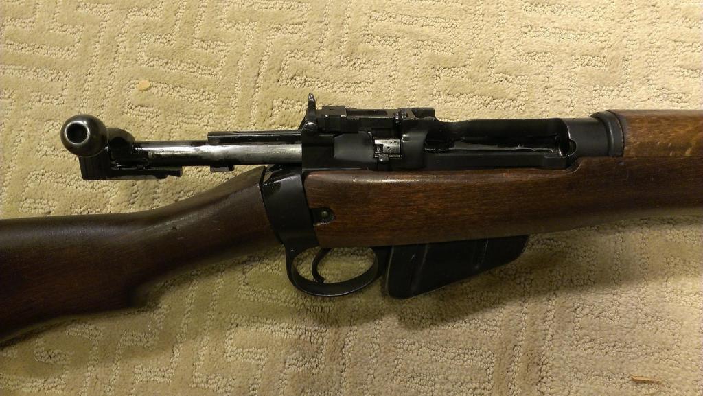

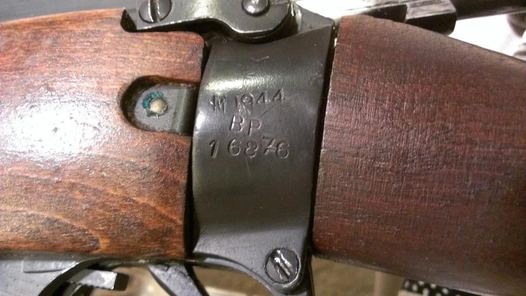

    Another Maltby No4 MKI*
    I too recently purchased a Maltby No.4 MKI*
    Here are pics:
    The gun seems to have been through an Arsenal Refurbish, as the furniture is virtually undinged -- appears to all be replaced -- but no dates of Arsenal Repair or overstamps.
    What does the * indicate? I've read through this earlier post, but did not get clear about the "*star." Note: The star is "six pointed" (the LB & SS MKI* are "eight pointed"). Was * added to indicate a refurbishment or was it original to the date of manufacture? Any new thoughts?
    Thanks, Robert

    We've seen quite a few of the Maltby supposedly Mk1* rifles. All I can think is that when this designation was being introduced as one of these '.....all further production rifles will be designated....... blah blah......' the message got to the production managers floor at Maltby who instigated it. Only to learn that this information instruction was just that, an information that told of Mk1* ( Mk1* is just a simplified way of advancing the original old numbering system of Mk1/1, 1/2 and 1/3 and so on) was the new designation for US/Canadianicon production only.
    Saw one such 1* Maltby last Saturday that had been advanced to 1/2 in the usual way

    Check the forearm especially on your rifle Seaspriter. A ton of that South African replacement wood was imported/sold in the past 20 years through commercial channels here in the USAicon including myself and it may have been fitted up incorrectly if not done "in service".

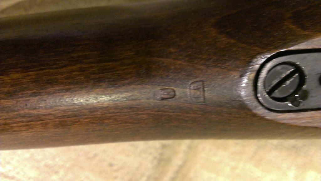

    Thanks Brian, I will take the fore-end and hand-guards off and check interior stamps, etc. when I get back home this weekend and report back. The Butt Stock is English Walnut. The hand-guards are beech. Not sure of the fore-end wood -- looks more like maple (no flecks) than beech, but seems a bit softer than most maple. I'll also check to see if the trigger has been converted to a MkII trigger. Would the barrel be always be replaced with a MKII upgrade?
    Thanks for the insights

    The forend is beech. I get a gut feeling it was a sporter that someone purchased the new wood for a restoration but I could be wrong. I wouldn't worry so much about the markings inside as I'd be looking at the fit in the draws and other bearings. It can't be a Mk.2 conversion because the Mk.1 forend wouldn't fit if it was. It doesn't sport the usual ROF(Fazakerley), conversion markings either.
    PS, It needs a new rear trigger guard screw!
