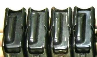

    The outside followers are angled, the inside two cut flat.
    As BAR says check the spring and end plungers. They could just be gunked up with crud.
    https://www.milsurps.com/images/impo..._zpsvnvu-1.jpg
    Thanks Jim. I'll start looking for the mags with the squared off follower. From what I've seen so far, it might take quite a bit of looking.
