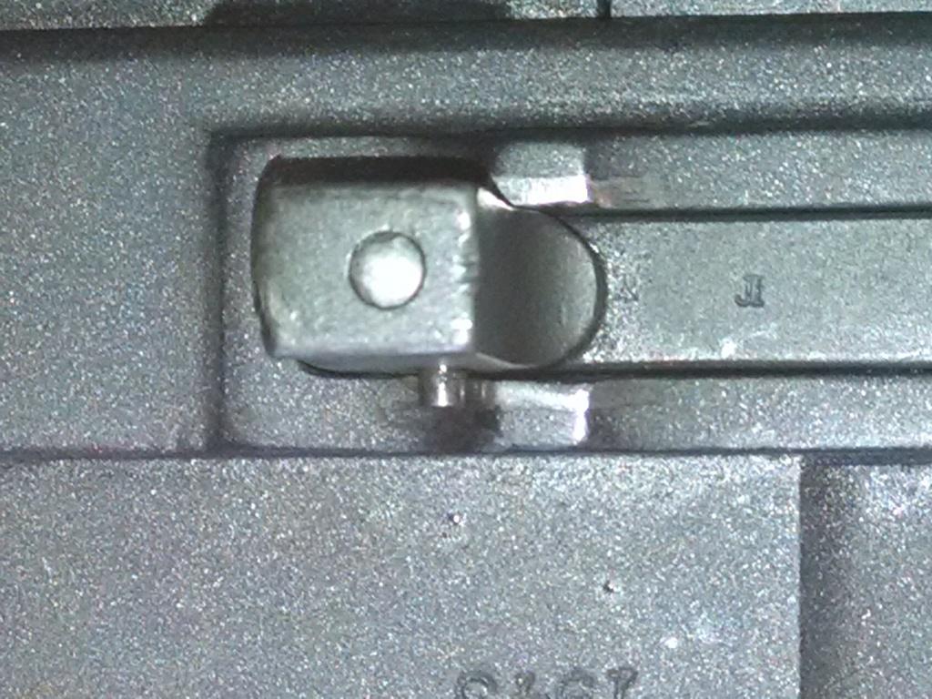

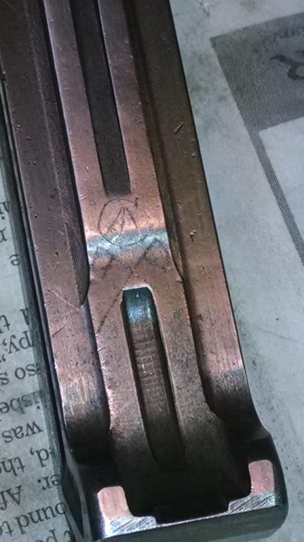

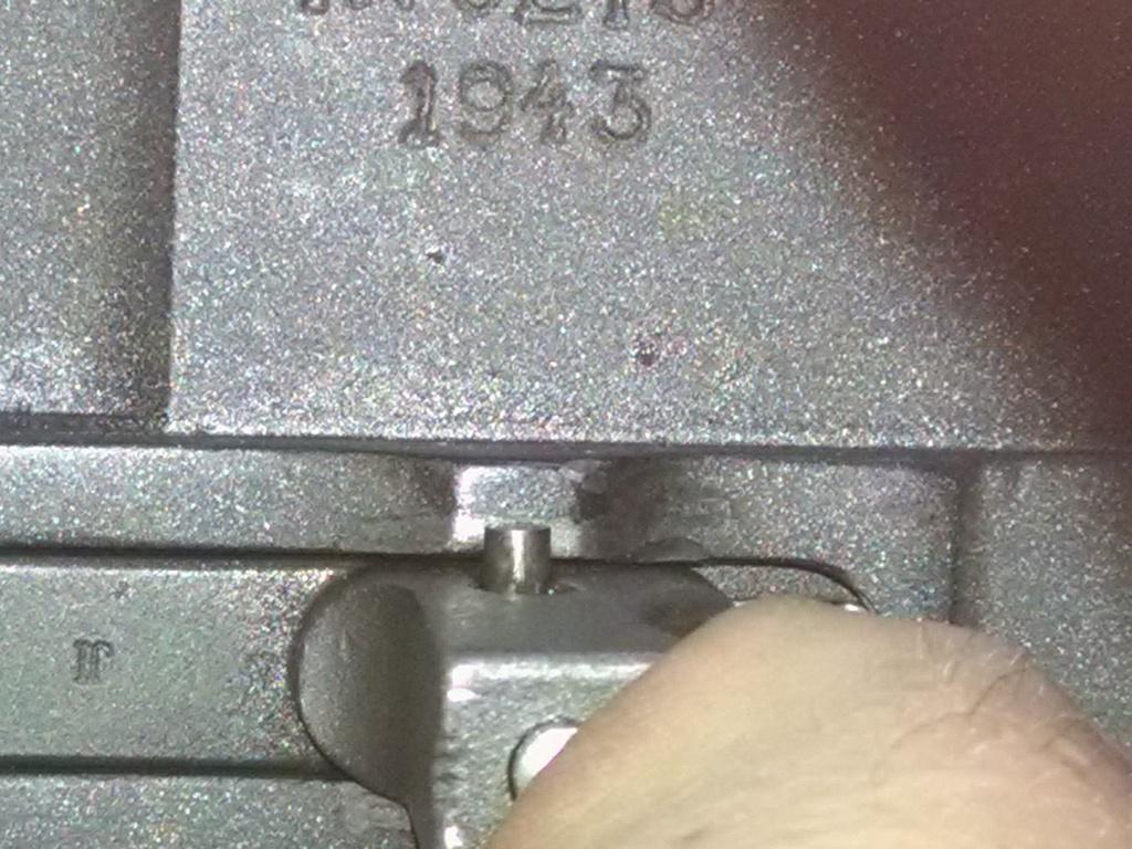

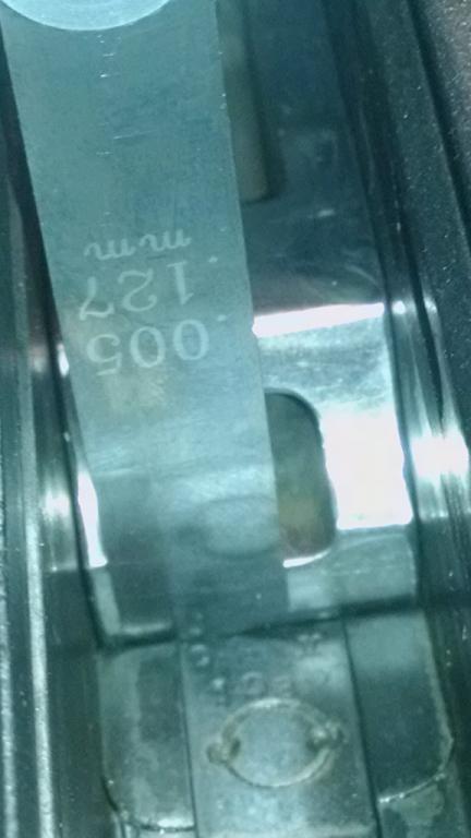

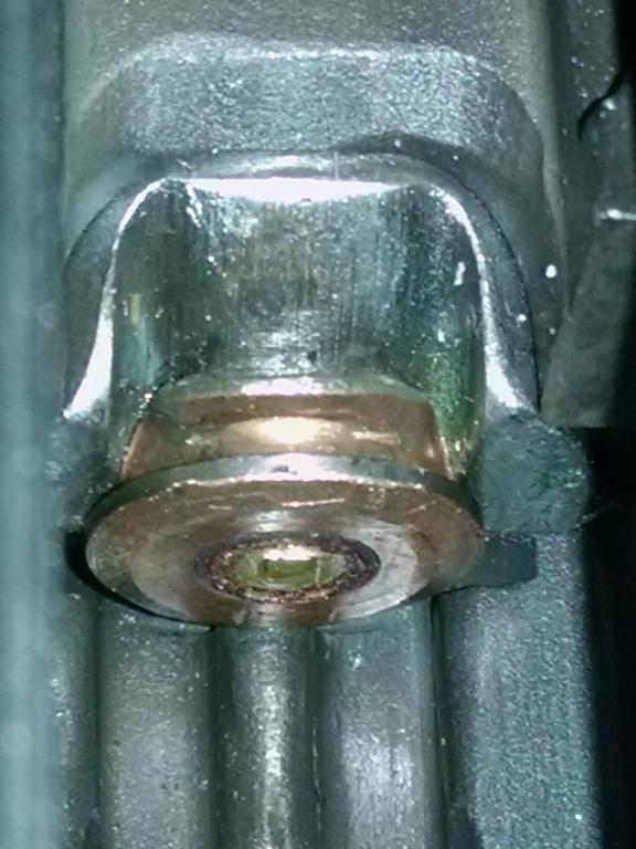

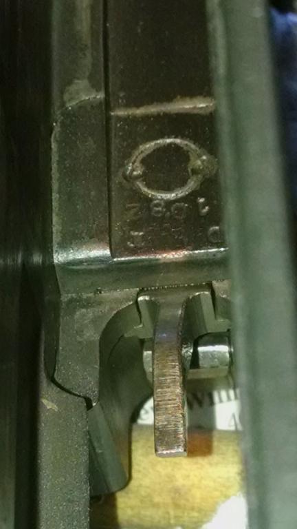

    OK gang - here are the new findings.
    1. Headspacing. Once the bolt slides down into the locking shoulders, there is no perceptible movement forward or back wards. I was unable to even get the .001 feeler gauge between the bolt and the shoulders. (assuming from Joe's pic posted above, that the measure of the headspacing is the movement of the bolt forward and back once down in the shoulders - if not tell me what I am looking for
    I have attached more pics of the components just in case.
    2. Firing out of battery. Per Joe's recommendation, I tried pulling back on the charging handle incrementally until it would at what point the firing pin would discharge the primer. the results per the video = it does appear that it will fire with the bolt slightly out of battery (I think that is what the video shows)
    Charging handle in it's full forward position.
    Charging Handle pulled back to the point where it would still fire the primer
    A VIDEO BELOW showing from the bottom of the receiver the point at which it would still discharge the primer.
    http://vid1200.photobucket.com/album...psfp8fne2r.mp4
    Now I can't explain how if I pull the charging handle back all the way and it falls with full power how the bolt can wind up being slightly out of batter when it fires.
    What do you guys think?

    If the head space is too tight, then yes. You will get a breech explosion. If excessive, then you will get a separated case, or even worse. A Blow out / Breech Explosion!
    The H/S limits are: 0.64"- 0.74". I looked at your photo's & say. you need to open your headspace from. 0.01" Thou. This is FAR Too Tight!!!.....Because yours is a semi-auto conversion & striker fired, I assume? The inertia of the piston extention going forward & even hitting the head of the striker. Albeit SLIGHTLY diminished from a 'Normal' blow.
    May well cause the striker to fly forward & hit the case primer. It would SEEM to Me from looking at your photo's. That your headspacing is In sufficient!...

    When the breech block is fully locked and safe - that is fully raised and positively locked in front of the locking shoulder - the cocking handle will still have .5" to go until it reaches its most forward point.
    This is another mechanical safety
    This is due to the fact that the locking ramp at the rear of the piston extension has ALREADY lifted the breech block up into its LOCKED position. THEN the locking ramp must move a further .6" forwards before the cocking handle has reached the end of its possible travel.
    Sorry to disagree with (or misunderstand) some of the threads above but looking at the pictures of the semi autos (and certainly on out standard auto's) and the movie clip, the guns cannot fire in an ulocked state while the locking bent at the top of the breech block is engaged with the locking shoulder.
    Off the subject a bit but to emphasise the action of the locking ramp on the piston extension. It is this ramp that acts on the rear of the breech block during the forward action. In doing so, the locking ramp is trying its hardest to lift the rear of the breech block which as a result frictions very hard against the roof of the gun body as it runs forwards. In fact it causes a measurable degree of friction that in normal circumstances you would want to eliminate. But on the Bren, this friction is a godsend because it is very effective at slowing the action of the gun right down. We come to a sensible compromise in the Bren by ensuring that the friction surface is restricted to two 'runners', one at each side of the top of the gun body (have a look......, that's the reason!) and that's why we put a smear of oil on them while preparing the guns for action.
    This friction laden movement is measurable in time too because using timed high speed video students can see and time the NON-friction loaded rearwards action with the friction loaded forwards action. (Not scientific I agree and there's more to it than that but illustrative of what us students needed to see!) Not a lot of people know that!

    djandj,
    From your description your headspace is far too tight (nonexistent) just as Tankhunter posted. I didn't see any shims on the case head so if you add the .003" shim I suggested plus the minimum .002" between the bolt and LS without the shim you should be reading .005" between the bolt and LS. To explain the numbers Tankhunter mentioned and I think he means .064" to .074". The case head is theoretically .063". So if the bolt could only move .001" then the headspace would be .064" far too tight for operation of military firearm. I suggested .063" +.003 +.002= .068" Bolt can move .005" (.068"-.063"). The upper level is .074 - .063=.011 that the bolt can move. The .074 is commonly called a Field gage. If the firearm exceeds this the rifle is removed from service and repaired. You do not use the Field gage to build a new rifle.
