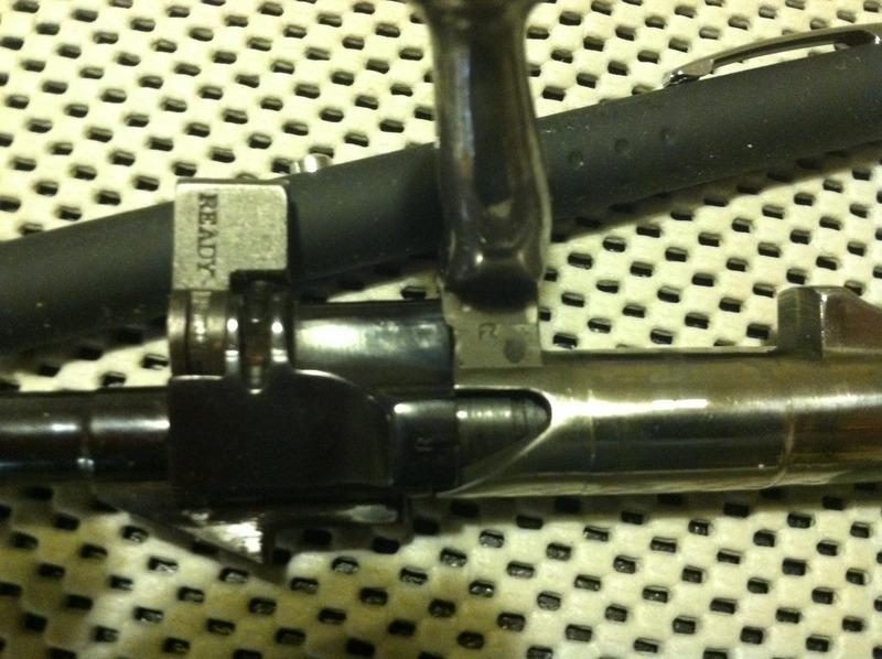

    Well, as the title states, I just got a sporterized M1903A4 for a good price. Found it Friday night on a Facebook page of all places, and made a 90-mile round trip Saturday morning to get it. It has been polished / blued, barrel shortened about 2 inches, has a Tasco scope and rings, and sits in a Fajen stock. However, it has the original bolt (polished only) and original Redfield base. All of the remaining USGI parts have "R" stamps. The S/N is 3411908, which sits in the first block of M1903A4s. The guy I bought it from said he bought it at a sporting goods store about 6 years ago, and has been hunting deer with it. He sold it to help get up a down payment on a new truck. I have some stock photos from FB attached.

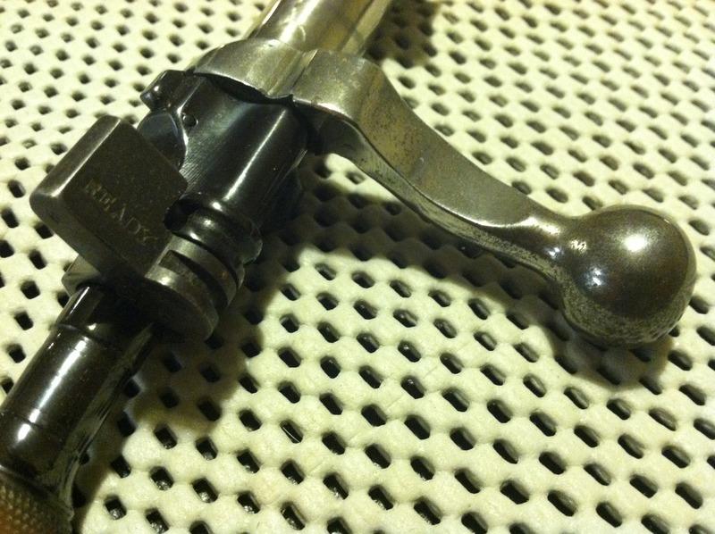

    looks by the pictures..that the bolt is not correct

    Yeah Chuck, those pics are the ones the seller posted on Facebook. I looked at the bolt closely and compared it to some others I found online. I think it's legit; I'll try to post pics of it later today. It is only polished; a touch of cold blue in a couple of spots confirmed it.

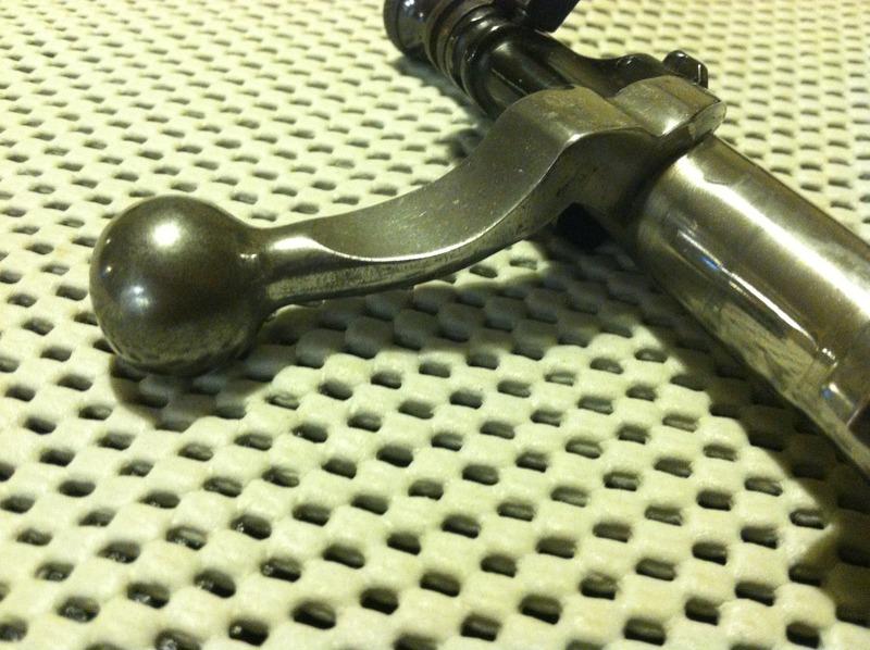

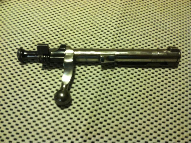

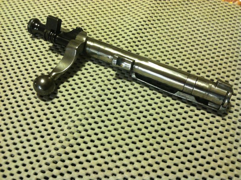

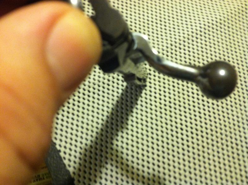

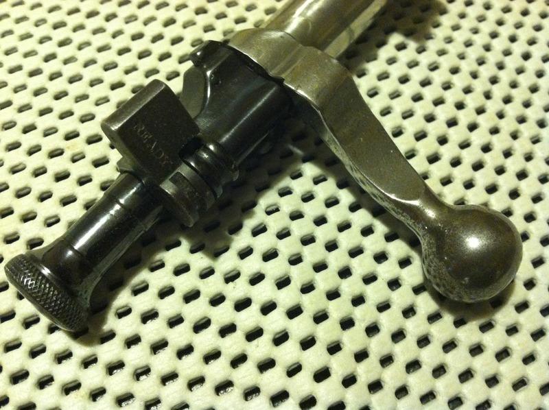

    Here are bolt pics, taken with iPhone:

    I vote original.

    bolt is good
