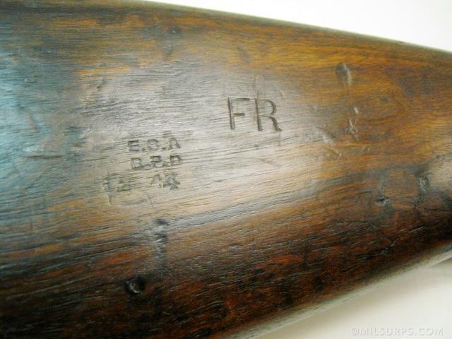

    Below is a photo of the butt of my favorite Savage Enfield. 77CXXX series (production ~ Nov 43), probably used during D-day, as it was sent for repair and repair was completed 12-44.
    First, does FR stand for Field Repair or Factory Repair, or something else?
    Second: obviously the butt was replaced (looks like American Black Walnut -- the original would have been birch), but also the bolt was replaced with a Savage 59CXXXX (~June 1943), and the receiver was Parkerized (not Suncorite). It was an early import into the U.S. with a BNP Nitro Proof (post 1954), and "ENGLAND" stamp, but no other import marks (my experience has been in the late '50s and early '60s, a paper tag was attached to label the country of origin). I purchased it from an estate sale and its condition was untouched from the time of import.
    Third: Given the repairs to the butt stock, what is the chance it was taken off another battle-weary gun?
    Fourth: Does anyone have any detail on Repair Standards for Lee Enfields returned from battle to be reissued? Were they repaired in a Field Armoury (i.e. in Franceicon behind the front lines) or returned back to the UK? As Captain Laidlericon and others have commented (don't let me infer anything here), it was more of grab what ever was in the parts bin, make it fit, and move it out! -- a wartime standard. This, of course is quite different from a post war FTR program or normal base arsenal repair.
