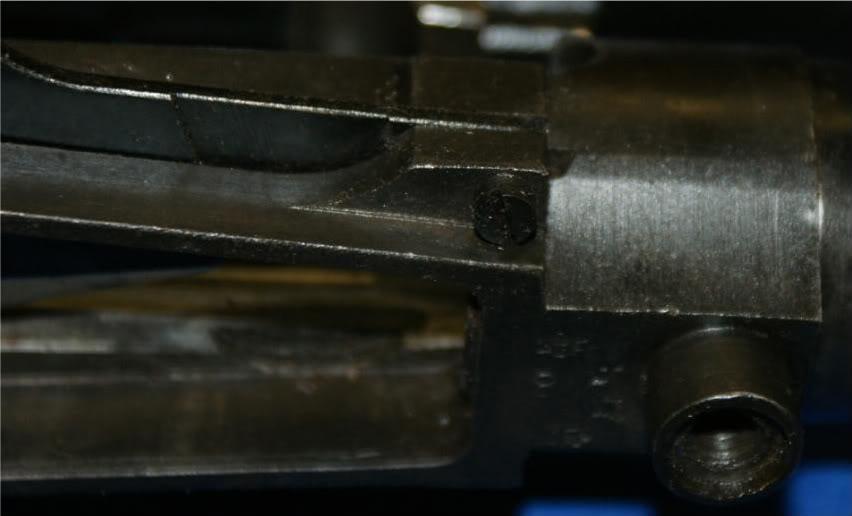

    A late No.4 Mk.2 shouldn't (in theory) have the vestigial boss on the right lower front of the receiver (action) body. I.e.:
    Versus the original version:
    The No.4 rifle's magazine cutoff feature went away basically immediately, but the extra metal on the action remained almost to the end of production. (Not including the No.5 Mk.1 rifles!)
    So late No.4 Mk.2 rifles generally don't have the extra metal, and the fore stock inletting was changed to avoid having a void.
