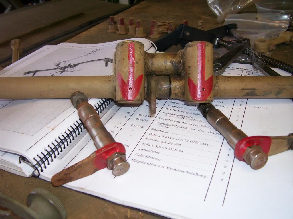

    Quote Originally Posted by Dark Alley Dan View Post
    Good thinking re: pits. She's been places and done things. Bondo would be kinda disrespectful of her history.
    How did you do the stencils?
    The pitting is honest and part of the vehicles life and if I was to slap the bondo on it it would be like icing a cake with the stuff. Stencils came from Franceicon and are dead on copies taken from original stencil work. One HUGE suprise I came across that I found REALLY cool was this steering brake shaft and parts, This was up under the dash pod and not exposed to elements (very much). Considering how rusty the kett was this blew me away. The Germans where big on painting grease points with red and all the red and hand painted arrows showing the little soldat where to hook on the grease gun fitting are 100% original and correct. The only fresh and new paint on this part is on the left hand side of the shaft while the good side was preserved as found.
    Guys I am really just bringing over my posts from CGN on this restoration so things may look a little jumbled. I feel this is sort of important as it is something, some anonymous person took brush in hand, and hand painted the red arrows to point the zerks out for greasing. Something I never said over at CGN was I took a small paint brush one day and stood there holding it as a person did 70 years earlier would have done.
    Henry R - Good points, but since then my knowledge and skill sets have moved forward, I would certainly not go about hammering the X in as I did today but it would be a great female die for pressing the X in place. The hammer method was just a one off event.
