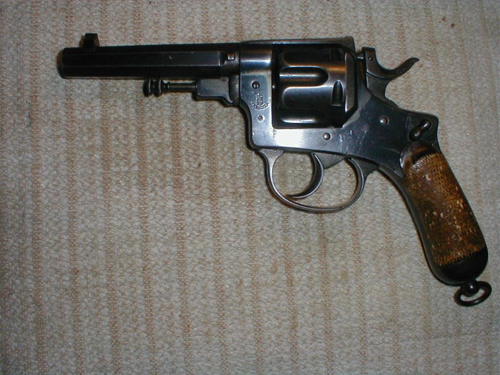

    This thread is partially in reference to Aragorn's Bodeo posit. I saw this lamp on ebay last November with a price of $119.99 plus shipping. Either it was a repairable 1889 Bodeo revolver or I paid too much for a very kitschy or as my wife said, very ugly lamp. At nearly sixty-six years I have risked more for less so I pushed the buy it now button and in due time it arrived. The first two pictures are the ebay photos. With a bulb inserted, it even worked!! (9th pic).
    It was quickly determined that it was indeed the "Real McCoy", made by Glisenti at Brescia sometime after 1889 (4th pic). The serial number is B2131 with no date stamp and if I've read the internet sources correctly, it was made before 1900, perhaps 1892 to 1894. Hopefully an Italophile on this forum can be more specific. I opted to try and restore this old beast and if unsuccessful, I still would have an unusual lamp for the gun room. I have since read that Interarms did these lamp 'conversions' sometime in the '60s but have been unable to confirm that information.
    First the bad news. It was arc welded to a horseshoe at the end of the butt and painted with a thick coat of black paint. The cylinder was welded to the frame in two places on the left side (6th pic). A threaded lamp adapter was welded to the muzzle looking somewhat like a one time use only, silencer adapter(8th pic). The trigger and hammer were tack welded to the inside of the frame, the hammer had been cut just below the pivot pin and the hammer face (firing pin) had been ground flat. The lamp cord required access through the gun so a hole was drilled in the left hand grip and through the rear of the frame at the firing pin hole. Last and probably least the lanyard ring is missing. I will post more as my time allows. Tom

    After removing the bulk of the lamp parts the horse shoe was removed with a Dremel tool and the paint stripped with Jasco paint remover which wouldn't effect any remaining bluing. The welds on the trigger, hammer and cylinder were also removed with the Dremel and then the revolver was completely disassembled. I chucked the barrel in my lathe and faced off about .010" and chamfered it to remove all the remaining weld spittle. Next in the lathe was the cylinder for the same process to remove the bits of weld left over. Interestingly, the cylinder has the serial number stamped on the front face. The remnants on the inside of the frame were dressed down wit the Dremel, needle files and various grits of silicon carbide paper. Tom

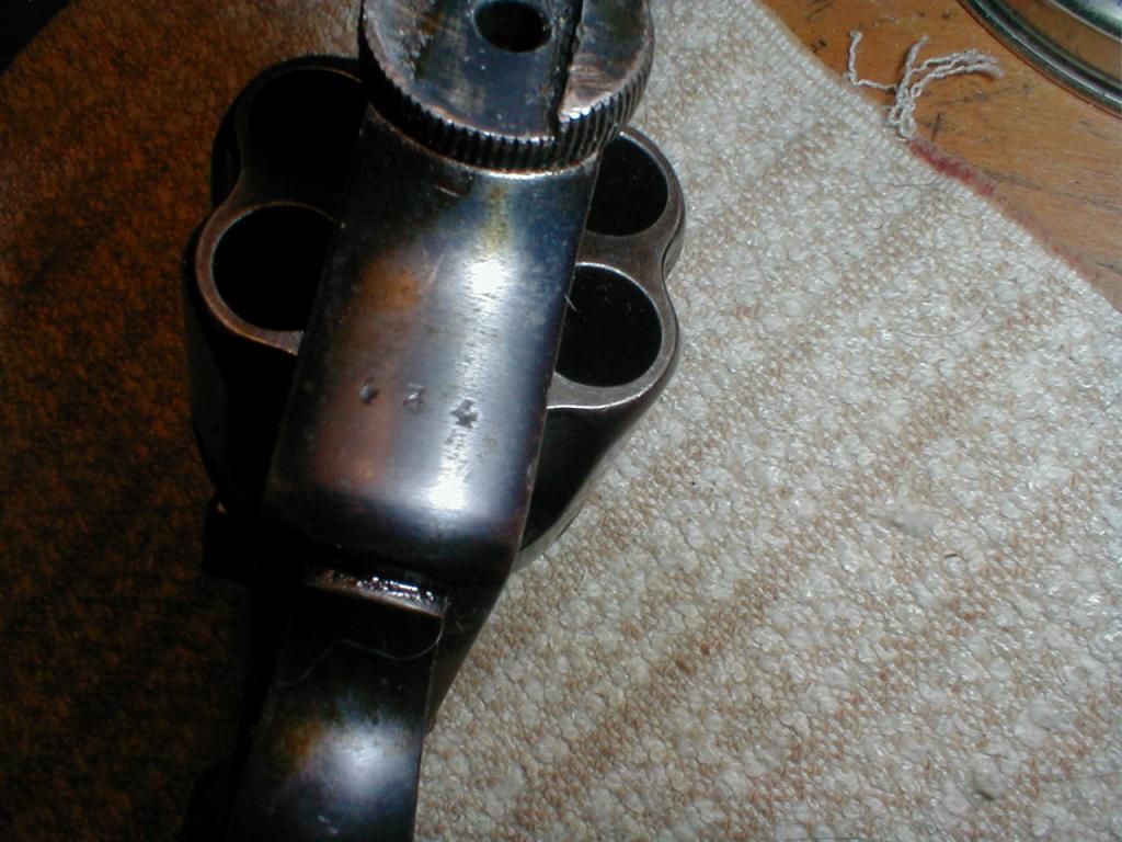

    None of the usual parts houses had anything listed for these guns but I was able to source a mainspring from a member on another forum and a hammer, hand and some extra internal bits for a reasonable price from a gentleman in Florida. Sometimes luck works out. In that same lucky vein, the bore has deep sharp rifling and promised the possibility of decent accuracy if I could repair the bigger problems, most serious of which was the rather large hole drilled in the rear of the frame for lamp cord access. The hole measured about 11/32" (0.3438") and was slightly oblong in shape. A letter drill size T at 0.3580" cleared the hole and made it round. The hole was tapped to 10mmX1.00mm and I turned a plug to an interference fit with the same thread pitch. With the plug in the freezer for a couple hours and the frame warmed up to glove wearing temperatures the plug was screwed in quickly before the temperatures equalized and when cooled the protruding parts were faced down with hand tools. A moment of paranoia caused me to stake punch around the plug on its periphery(pic 5) but in retrospect was probably unnecessary. The picture of the plug repair on the inside of the frame(pic 6) appears to be wavy but is perfectly flat. The tapered firing pin hole was next and certainly the most tedious and time consuming task in this project. I will save that for my next post. Best. Tom
