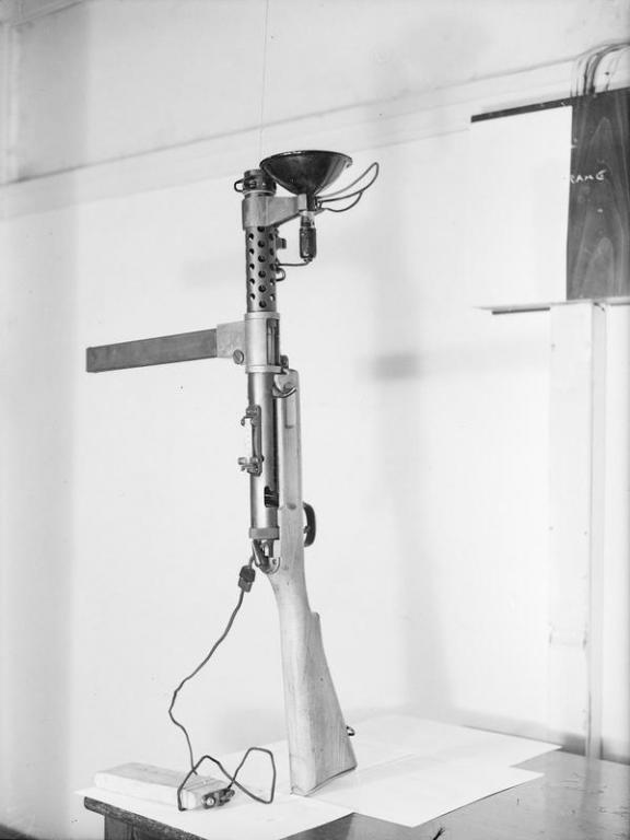

    I like the experimental Navy tactical light.
    Pretty advanced for the day.

    And the curved cocking handle too. The latter 'standardised' ones the Navy retained were simplified to the Nth degree

    Thanks Peter. I hadn’t thought about the cocking handle. I have the simplified one. I will see if I can get my hands on an MP28 cocking handle.
