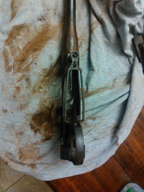

    Electro penciled or stamped markings generally don't just wear off.
    I've seen markings removed during a refurb but they are generally replaced.
    I do see a broad arrow but no other markings at all, seems strange.
    There should be markings identifying it as being made by Fazakerley or BSA the only makers of No5's.
    Every part of my 1945 Fazakerley has a marking or number or both on it.
    I'm just hoping you didn't end up with one of those Khyber Pass knockoffs that are dangerous to shoot.
    You really need to go over that rifle very very carefully with a magnifying glass to try and find any hidden markings before you put money into it.
    Look for all the genuine No5 traits, fluted chamber, hollowed bolt handle, removed action lug on the right side behind chamber,
    trigger guard figure 8 shaped by the front screw, hollowed out sear ect. None of your pics show any of any of these id factors. - Bill

    Hear what you're saying oldfone (thread 23) but Fazakerley markings, done with what we called 'the scratchy pen' (or electric pencil mounted in a pantograph frame) were notorious for wearing off. Once in the bead blasting booth, they'd be off in seconds. We didn't bother ourselves with replacing manufacturing or designation detail. But we always replaced missing or obliterated numbers.
    Regarding wood treatment. We knew all about extreme zapping heat, monsoon rains for most of the year, salt water, mangrove silt and beating sunshine in Malaya as it affected our rifles and machine guns so am at a loss to understand why we didn't use tung oil or any of the other super-dooper concoctions. All our woodwork was dunked in a constant warm-to-touch linseed oilicon bath for the day and left to drip dry. And that is STILL the specified treatment on our wood today - as I have just confirmed in a phone call!
    Just seen the recent photos. That's no different to the hundreds of No4,s 5's, L1A1's and shotguns, Brens and SMG's that used to go through the Base workshop system every week

    Just saw the updated pics, yea it looks real enough to me.
    Even through the rust and the dirt you can plainly see it doesn't have any of the crude hallmarks of a Khyber Pass receiver.
    It doesn't look like cast flash has been slightly filed and then it was painted with a roller!
    She looks like the real deal and I'll bow to Peter's expertise, but I still wonder why no numbers were replaced. - Bill

    I'd say no numbers have been replaced since it hasn't been through the FTR process.

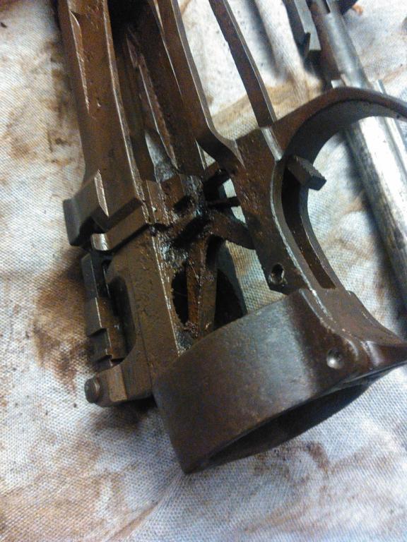

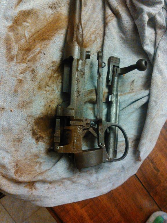

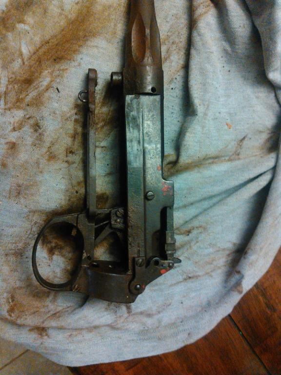

    I realize I'm reviving a 5 year old thread, but I'm doing so with good reason.
    Shortly after starting this thread, we sold our place and moved. As a result, this project got put off. This project has been wrapped in an oily old t-shirt and only brought out here and there to make sure it wasn't rusting or the like.
    I got to getting into tearing everything down to start working on it and bringing it back to life. As a result, the screw that goes through the rear of the trigger guard holding it to the bottom of the wrist had to be drilled out. Soaking for several weeks, heat, and other methods didn't get it loose and the chewed up screw head (like that when I got it, you can see in the pics) broke half of it off. Sucker was flat siezed up and took some work.
    I have a small ring of old screw still in the threaded side of the wrist I'm working on figuring out how to get out without damaging the threads. However, what I can see of the threads I'm half afraid someone before me may have boogered them up a bit.
    As such, I'm working my head around the next steps and wondering if I'm going to have to chase the threads when I get the ring of what's left out. Trying to make sure I've got the right threads, though. From what I'm finding, it is a Britishicon 4BA thread? So I'd be looking for a 4BA tap, if that's the case.
