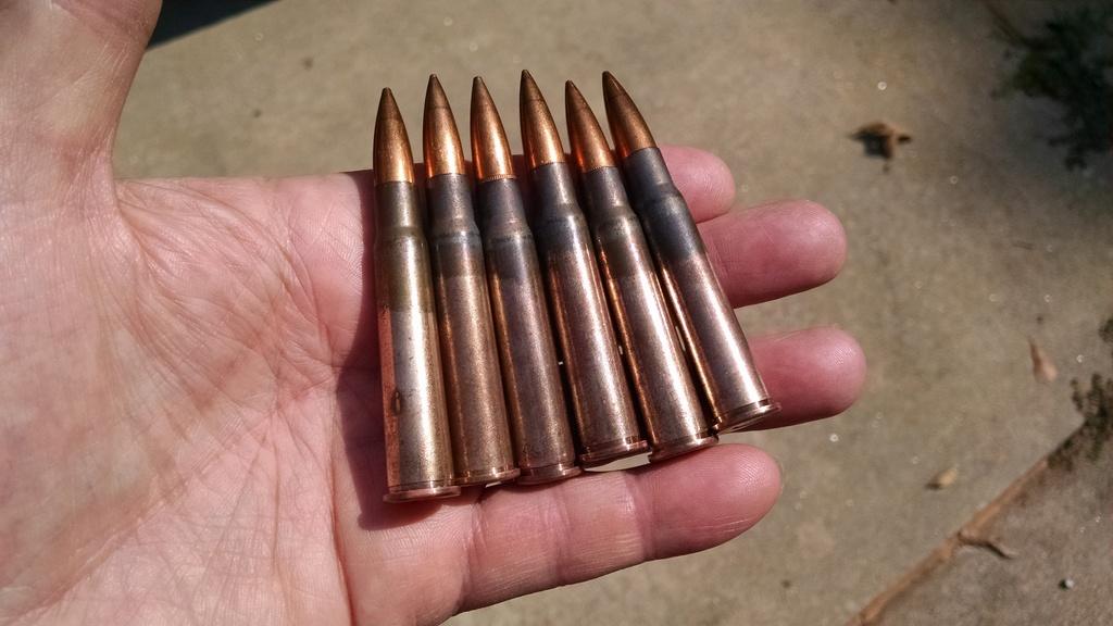

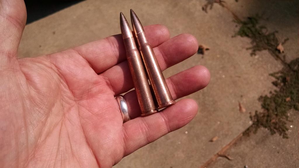

    Bought some of the Grade B Greek 303 from CTD last year and had a couple of boxes that were tarnished enough to be unsightly. a fellow mod on another forum bought some as well and he also had some that were tarnished. A quick and easy way to remove the tarnish can be accomplished with a little Lemishine and water in 5 minutes time. This only removes tarnish, it will not make the brass shiny bright nor will it remove any corrosion.
    Arsenal loaded military ammo is typically waterproofed by a lacquer sealer around the primer, and an asphaltic sealer in the case neck. If these Dutch rounds are indeed reloads, they probably aren't waterproof, but one could seal the primer with the wife's nail polish, and stand them in a pan of water that does not submerged the case mouth.
    C&P from the other forum this is posted in...
    Dissolve 2 TBL Lemishine in a container of water. I used a 4 Cup Pyrex pitcher, but something large enough to hold one box (48) rounds of ammo.
    Set a timer for 4 minutes. By the time you get them out and dried, they will have been wet for 5 minutes. If you leave them in too long, they will turn pink. Doesn't hurt anything, but someone may give you a rainbow hat at the range.
    Place the 48 rounds in the container and start the timer. When the timer goes off, remove the ammo and thoroughly towel dry.
    You will notice the necks have slightly pink tint. This was what they originally looked like after the factory annealing. They then darken over time.
    Very important:
    Lay the ammo out to air dry at least overnight. If it is the least bit damp and you box it back up and seal it up in an ammo can, it will at the very least re tarnish worse than before.
    This process will not leave the brass shiny bright, it will only remove the tarnish.
    You fellas than don't use the SS pins can also use this method to pre-clean grungy range brass before it goes in your tumbler.
    These rounds were used to determine immersion time. You can see they can stand to be left in a little longer.
    These were left in for 5 minutes.
