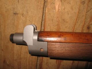

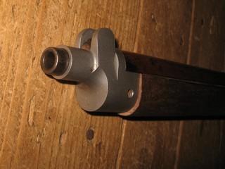

    This is a nose cap from the latest and final batch of nose caps produced on the CNC mill. I now have enough to last me a lifetime of projects. Now to work on barrel bands and retainers.....
    The program was tweaked a bit to correct a couple of things. Pretty much perfect now. The only way to tell that they are repro is that they are just too perfect. They are too 'crisp' at the corners and edges and are perfectly symmetrical about the center line.
    Obviously they have no inspection marks, although I might initial and date them inside somewhere hidden.
    This one has been bead blasted to mellow it a bit. They are made from mild steel and take rust blue nicely.

    They look great and the fact that they're hen's teeth make them acceptable. The rust blue will make them about perfect.

    Throw them in a gem tumbler with a bunch of ball bearings and some smooth pebbles for a few hours and then have a look.
    They will probably have "aged" a bit.
    As for finish; try the "blazing off" trick I mentioned above, as well.
    I have an original one of those nosecaps here. Now all I need is the rest of the Carbine.......
