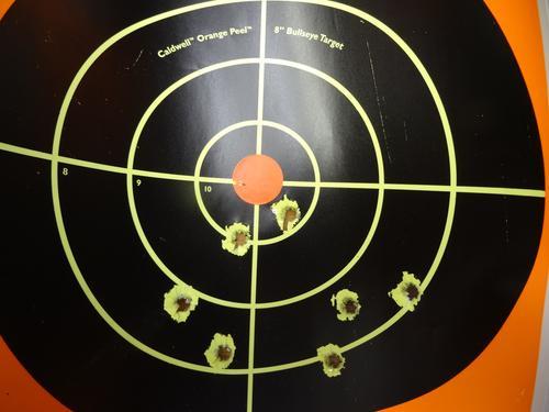

    We shot some of the PPU "Garand -safe" ammo and some Hornady 150 gr CMP "range ammo"
    The SG seemed to like the Hornady ammo a little better. My son (who is a better shot than I), shot this 100 yard group with the PPU
    I shot this 100 yard group with the Hornady ammo.

    I'm continuing to get to the range and shoot various ammunition in my Garands to nail down the best for each one. This afternoon I got to the range for a few hours to shoot a couple of the Garands and a few Swissicon rifles.
    I tried some Hornady 168 gr AMAX M1icon Garand match ammo and a clip of my handloads in the service grade.
    Here is the Hornady match ammo @ 100 yards. The first round hit down at 7 o'clock. I made a sight adjustment and then shot the remaining 7.
    I then fired 8 of my handloads...IMR 4064/168 gr Nosler CC. The service grade like it almost as much as the Hornady match ammo.
