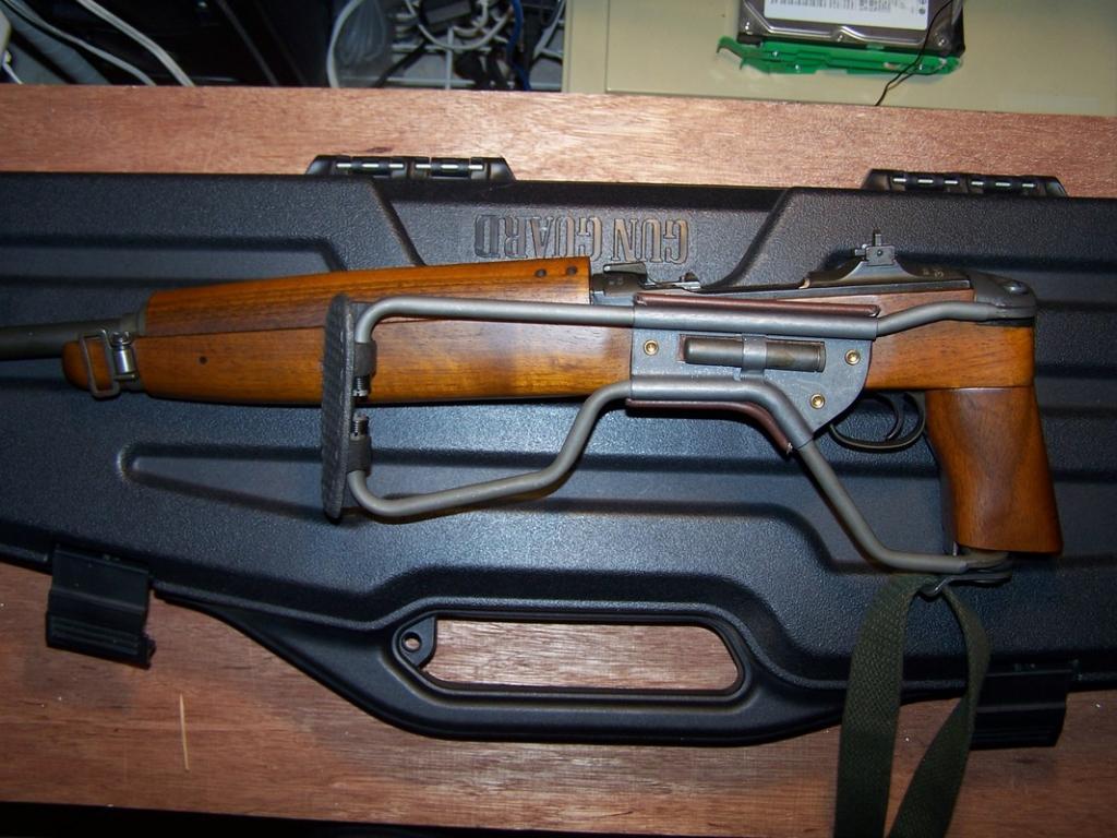

    Update: A second coat of BLOicon did not soak in or dry overnight. Big difference on my dry old stock, which soaked it right up and dried quickly. Had to wipe the Inland stock off this morning and a bit more stain came away on the rag. Not enough to change the color though. They must have applied the stain incorrectly or used too much. If I had taken it to the range out of the box my palms would be brown by the time I got done shooting.

    I am curious about that since some of the stain came right off on my palm before I had put any oil on. This morning the stock is dry and the stain seems to have finally set in.

    Only difference I can see is the big flat rivets on the cheek pad instead of the brass original style ones. I bought one from Inland because I want to support the family trying to make a successful go at preserving the name. They have some work to do though.

    Follow Up: After I sanded the front lip a bit and the nose on the forestock I could close the barrel band and get the screw in but just barely. Today while reading a reference thread on CMPicon forum I learned that when everything is fitted right the back end of the action is wedged and held in place so that the barrel is "floating" in the barrel channel.
    From the thread: "It is incorrect and possibly damaging to pull the barrel down more than 1/8" to get the band on the stock." That was my case at first. The nose on the forestock is definitely too thick. I used a dremel with a small tube sandpaper to make a cutout all around where the band rests rather than sand the entire nose and now the band fits.
    The recommended fix in the link if the handguard is interfering with the barrel band is a low number sandpaper sheet flat on the bench to take a bit off the rails. So I used some 60 grit and the barrel band goes on a lot easier at the top.
    According to the link info my earlier fix could result in poor accuracy or cause damage. This is probably old news to you guys with a lot of experience but posting it for other new guys like me. I am always grateful for the info here and on other forums, I have dodged a few problems thanks to the community.
