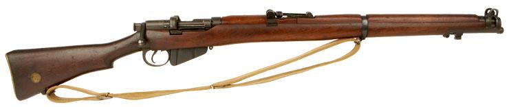

    What they're trying to relate is that the pictured relic was once an Australianicon military rifle, which was made with a breech chamber fitted to a cartridge known as the ".303 Britishicon", .303" being the nominal diameter of the hole bored lengthwise through the barrel.
    Some time after leaving military service, various portions of the wood and a few metal parts were removed to make it resemble the usual configuration of a civilian hunting rifle ("sporter"). In addition, a rubber pad was fitted to the butt end of the wooden stock.
    Before alteration, it appeared very much like this example -
