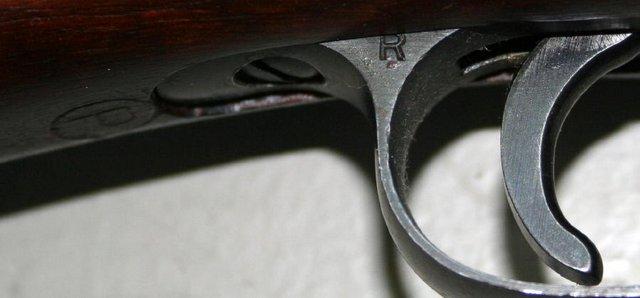

    Have been working way too many hours with no play time. I will post allot of pics this weekend. I really appreciate all the help so far. This is an excellent forum with many generous members.

    Stunning. Is that the original Remington bolt that has been polished or is it a replacement? or it is the original bolt you could have it re blued.
    Also it looks like you have a A3 mid band.

    Bolt could be a 03A3.
