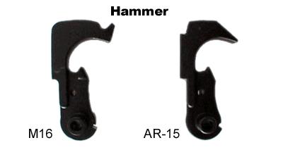

    I wouldn't think so, because most firing pins are fairly hard metal, but maybe. I have a TT33 that has a bent pin and works 100% reliably, there was no external evidence of the bent pin just odd "scuffs" on the fired primer (bent on the nose end)s of spent brass. Once I pulled the pin and checked it against glass, the bend was obvious. I ordered a $40 (price+shipping) replacement from Numrich but it was too short it wouldn't even fire, so the working but bent original is back in place and shooting fine. The second experience is from my own Civilian AR15, while doing reassembly, which I had done with C7's thousands of times before, the upper and lower was 'hard' to assemble, no obstructions were found and with a bump and it went. Testing again everything would hinge open and closed smoothly, and it passed the function test, but next trip to the range, sometimes it would go click, sometimes bang.
    I stripped the bolt and found a bent firing pin, (bent on the tail) and wondered how that could have happened. About 30 second later I had it figured out, military and some civilian rifles have the proper "rounded" hammer but my civvie rifle had a "non-full auto" hammer which had a step cut into the face. If the hammer were not cocked on reassembly, it would strike the aft of the firing pin and bend it. A proper "FA" hammer would just slide past and not cause a concern, I know reassembly with a cocked hammer on SAFE is proper, but over the years muscle memory sometimes shortcuts past "the proper way". Anyway I always kept a spare pin, and for the first time in a decade of firing the AR platform, I found a reason to use it, a minute or so later the rifle was back on the line and running perfectly. Neither one had any scuffs or evidence of the clearance issue.
    For reference:
    Getting back to the P17, a bent firing pin (or some other drag) could cause light primer strike issues, despite the heavy springs, it would hopefully be the lowest cost and least hassle fix for this rifle, it would be a shame to see a guy have to search out a new bolt, or mess about with headspace.
