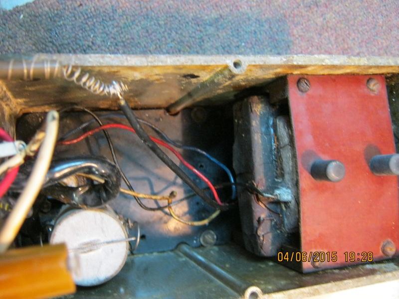

    M1/M3 IR power pack
    Would any one know ho repairs the M3 Infrared sniper scope power pack. I think the one I have was rebuild in the 80's & uses a 6 volt battery. It has a small problem. You turn the power pack only on & not to long after it blows a 10-A fuse . I did have the scope on a carbine & squeeze the IR trigger had a green light & heat from the light filter & not long after it blows a fuse. Thanks for any info.

    Quote Originally Posted by can14 View Post
    I had an electronics guy work on mine. He came to see me , saw it and took it home. He re engineered it to
    work better than original, in his opinion...lol But it does
    Can14 Will probably do the same if I can find one. Does or did the inside of you power pack look like the one I have ???

    you are missing parts. the transformer also looks like it has seen better days

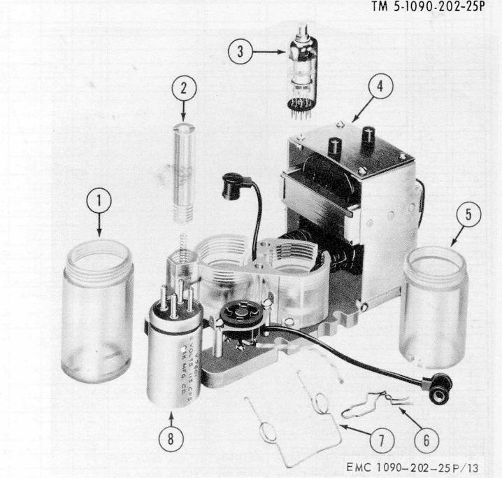

    your missing the plastic parts. in the base goes two rectifier tubes. and the high voltage output is the thin tube. the cups goes over the tubes to hold them in place.
    Will see if I can get an actual picture tomorrow.
    If you look at the transformer you should see two sets of wire which are probably cut back. A yellow set and a blue set.
    The biggest mistake people make is powering up the unit without the scope attached. The high voltage seeks a ground and over heats and fries the spring which transfers the high voltage from tubes to high voltage cable that powers the scope

    new2brass
    I think my power pack was converted at one time. I don't think I could find the parts to bring it back to original. I did find a elderly gentleman that still works in old Electronic stuff. He spotted a broken part & a cable missing right off the bat said he can fix that & he will see what he can do to get it going. I gave him some info on how it works, a repo manual & the hole kit scope,power pack & cables. I got my fingers cross .

    Quote Originally Posted by gunsdora View Post
    https://www.milsurps.com/images/impo...yp70bhn4-1.jpg
    https://www.milsurps.com/images/impo...qdmyipfx-1.jpg
    https://www.milsurps.com/images/impo...elstndwo-1.jpg
    Does any one know if there is some one ho re-builds this power packs. The guy here cant repair the one I have. Not sure if it is worth repairing .
