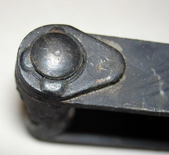

    Quote Originally Posted by Vincent View Post
    Is this the bushing modification?
    https://www.milsurps.com/images/impo...tt20hole-1.jpg
    It looks like the bushing is welded in.
    Yes, but not a 'Normal' Brit repair. We would have brazed the bush in. Much neater!
    ---------- Post added at 01:59 AM ---------- Previous post was at 01:53 AM ----------
    Thanks. It sounds like I should just replace the ‘butt pivot’ with a newly made one. We call it a ‘trunnion’ over here. Not difficult to make. I could do away with the pins and use e-clips, like on the Canadianicon C1 SMG.
    Yes indeed! Trunnion is more correct! don't forget, ALL projections/Fittings on the Sterling Receiver. Were electrically heated & brazed on in the factory. They were aligned on a jig to hold them correctly in place prior to 'fusing' on the receiver tube.
    For the butt especially, it is CRITICAL to align the Trunnion properly. Or the Butt wont line up with the butt holding lugs recesses. On the inside of the Return spring end cap, When opened up!....

    In NZicon I think the repair bush on the butt was soft soldered in place in the reamed hole and then filed to thickness to eliminate side float. No need to weld, braze or hard solder because it ain't goin' nowhere!
    We didn't use that method of repair but ploughed on with the ring punching method that solved the end float - temporarily. But still didn't solve the side float. Whereas the NZ Army method solved BOTH problems at once, permanently.

    Quote Originally Posted by tankhunter View Post
    … don't forget, ALL projections/Fittings on the Sterling Receiver. Were electrically heated & brazed on in the factory. They were aligned on a jig to hold them correctly in place prior to 'fusing' on the receiver tube.
    There’s a picture of a pivot/trunnion jig being used on the spot welder in Peter’s book (p144). That spot weld can make getting the pivot/trunnion off the tube quite difficult. The braze melts with no trouble, but that spot weld can be a problem.
    Yes, that’s critical. What I found what works for me is clamping the butt in the end cap, with the cap pushed into the open position for the butt and the butt locking lugs aligned to just clear the recesses in the cap. Mind you, if you didn’t get the end cap locking ring aligned correctly on the receiver tube…
