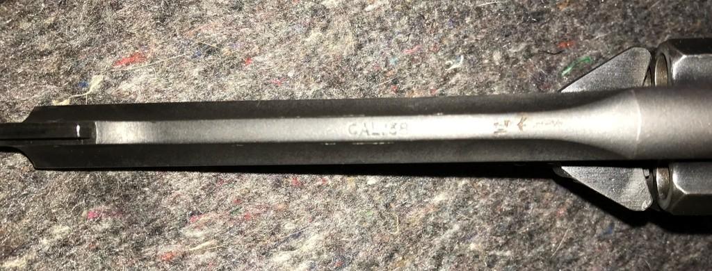

    Enfield No2 MK*
    Wood grips, good condition, shiny bore. Has a faint import mark on the bottom of the barrel. Bought it figuring the holster was a repro but now think it's probably original as there a lot of these in this condition on the market. Import crudely etched serial on the butt. Not sure the reason for this as the serial number is on the bottom of the frame.

    Gun looks nice. The holster is likely good, the proof mark looks right to me. They made scads of them so there should be enough new ones to carry on until rapture.

    So what's with the wood grips? I know they were made, obviously, but my sources I've read all indicate plastic grips yet photos show numerous examples of the wood ones. Were these used early with plastic taking over as the war progressed? This has the later Enfield mark, no date that I can find.

    All the wood grips were made at Enfield and the plastic ones sub contracted for outside as production increased. The sort you have, both wood and plastic, were supposed to be the best and the only ones we could get towards the end of its service. Ours were all modified on the left side to clear the barrel latch.
