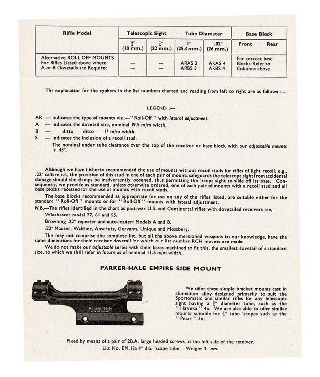

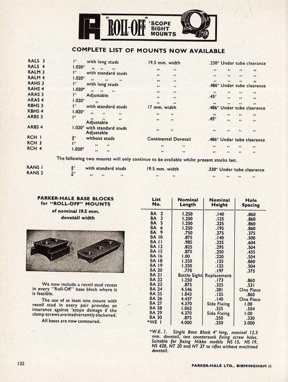

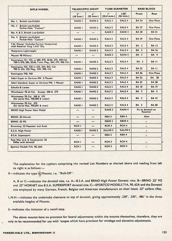

    Parker-Hale scope blocks and rings
    From the number of enquiries we have received here over the years, it seems well to reprint the P-H catalogue list of scope rings and mounts from Cat. No. 67
