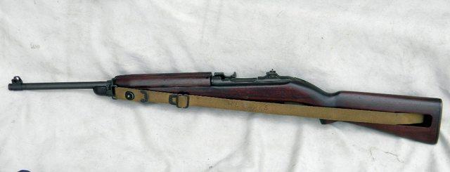

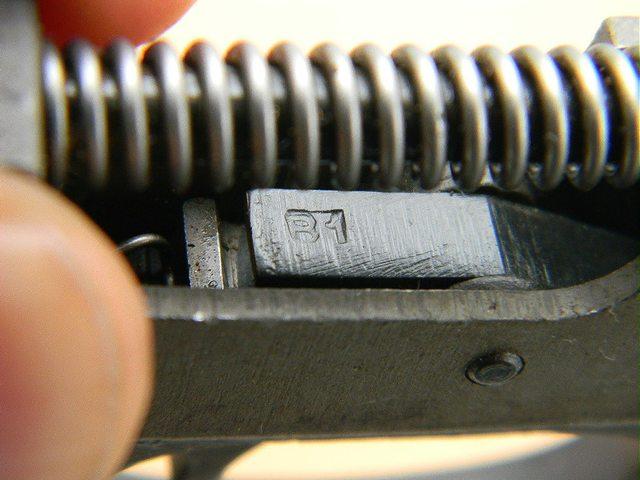

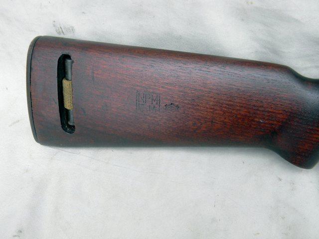

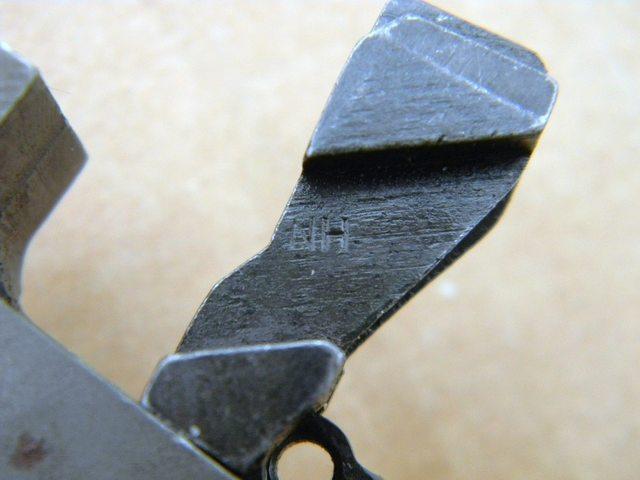

    Just picked up an as issued NPM from very late in the first block. The sear stamp is only part which doesn't jive with most references. It is not a BI sear, but instead a B1 sear.
    From the evidence and condition of the rest of the gun, I think it is a 99.9% chance of being original. I can't imagine that a near mint specimen would have had only a sear replacement post-WWII. The gun is not upgraded, and a Korean War bringback.
    The recoil plate has no visible outward marks, BTW. I won't be removing it to check, though. I think you will see why I choose to leave it alone.

    I bought it from the daughter of a recently deceased Korean War Army Veteran. Her statement was that her dad came home from the war and hung it on the den wall, and it didn't come down until last week.
    It did have about a ten year window from DOM to date of return, so there is a chance that something could have been changed out. But the condition just screams, "As-issued".
    There is a little pitting on the bolt face, so it is not un-fired since issue. But it saw no hard service, nor any apparent post-WWI upgrades.

    Just so you'll know, NPM used some type two recoil plates that had no markings on them. I have 1.511xxx that while not a mirror image to your carbine, it's very close. The finish on mine is better, but the stock and handguard on mine were both wrong; I've found both items recently along with a better sling. Your sear is odd, but I have heard of a few sears that have a similar marking to yours. I'd think a possible integrated part from someone, but I am not going to say that with any certainty to I look into it a but more. I prefer carbines like your that have a complete or near complete matching patina. It adds a certain authenticity to it that cannot be denied. Nice purchase!

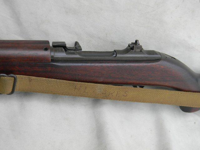

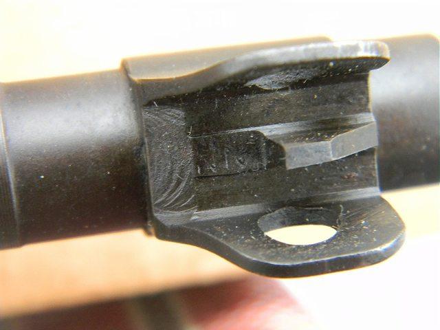

    NPM did incorporate small outside orders of sears into original builds, but the source of the B1 sear is tough to track down. I can only find one other reference on the net which has a similarly marked item. It is also in an NPM trigger housing with correct hammer and mag release markings.
    It is also possible that other B1 sears are mistakenly identified or reported as BI. There may be more of them than we think.

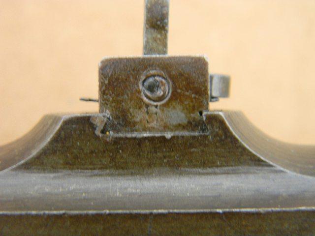

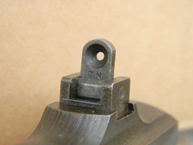

    On the patina, I do believe that it is mostly dried oil. There is likely a near pristine finish underneath. In order to show maker marks on items such as the rear sight, I needed to take a q-tip and oil to clean, or the letters would not show. The S-stamp on the left sight base is a good example. You can see a very decent finish around the cleaned area.

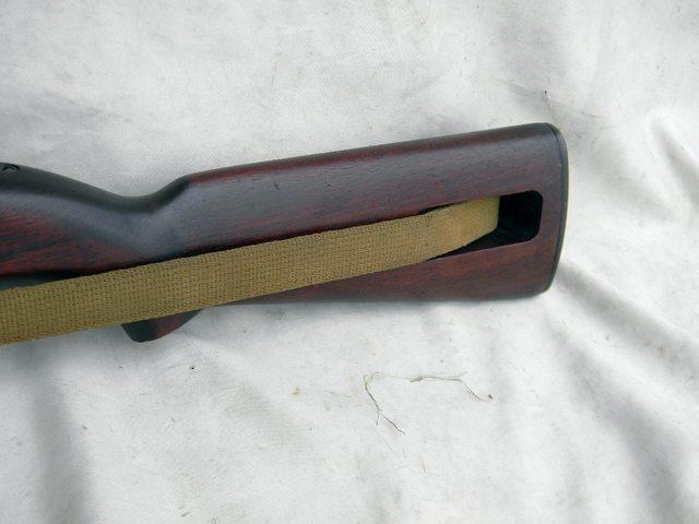

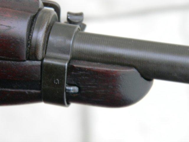

    I'm a stickler for leaving things alone, though. So the dried oil will stay. The stock had been finished with BLOicon by a local gunsmith just before the sale, and I did strip that with hand rubbing and soapy water. The raw linseed oilicon finish is ten thousand percent better. Here's a before and after.
