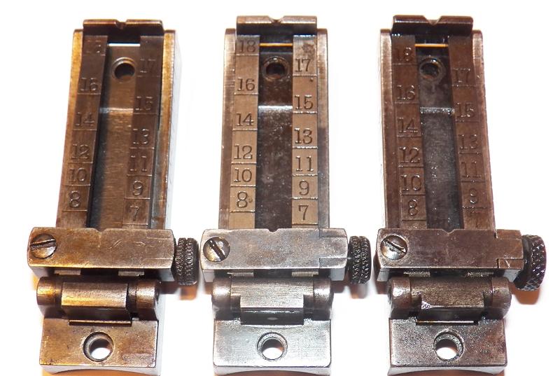

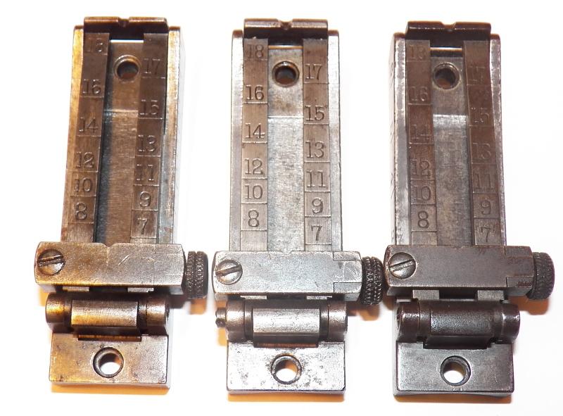

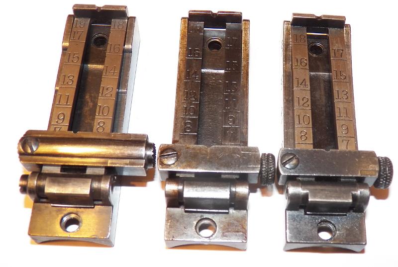

    Your sight?
    Middle one right? What of that one I have on the left?
    ---------- Post added at 05:06 PM ---------- Previous post was at 05:03 PM ----------
    One image per post apparently.
    Clear?
    ---------- Post added at 05:07 PM ---------- Previous post was at 05:06 PM ----------
    Which ones are those three?
    ---------- Post added at 05:08 PM ---------- Previous post was at 05:07 PM ----------
    Three M-1892s. Bottom rifle isn't. I cover that in the book. I have another now that makes it even clearer. Your rifle is an M-1892.
    Cheers.

    5MadFarmers - Wow, now I'm really learning what I don't know. There appear to be more variants of 1896 sight than I was aware of, so you can imagine how much trouble I'll have with that bolt. I would have thought that the bottom rifle was a late 1892. Back to researching!
    Thanks
    George

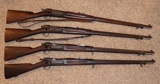

    What is a "Magazine Rifle?" A Kragicon from about 19K to 24K. Basically an M-1892 with ever increasing M-1896 features. See the butt plate picture in my book for a vivid example.
    Were M-1896 sights retrofitted to earlier guns? M-1892s? No. Magazine Rifles? Yes. If one cannot identify the Magazine Rifle for what it is, one then puts out a book claiming M-1896 sights were retrofitted to M-1892 rifles *cough Brophy cough*. No. Can I prove it? Sure.
    I have the reports.
    I own #21XXX. Not hiding numbers, gun is in the safe. In any event the fourth gun down in that picture is the Magazine Rifle.
    I own #23XXX. In safe so XXX. That is one of the Magazine Rifles altered to M-1896 format with the M-1892 extractor. "Pinned extractor with rivet?" Check. That picture.

    Yup. If it's curved toe it's a Magazine Rifle. Manufactured with the M-1892 sight and then retrofitted with the M-1896. Later those were fully updated. 21K was missed.
    OP's rifle has the flat butt plate. "M-1892." Rear sight? "M-1892." Why? "It's an M-1892." If that toe was curved it'd be in Magazine Rifle territory. Then it could have the M-1892 (as made) or M-1896 (retrofitted).
    If only I was to write a book on this stuff....
    Going to bed. Then vacation.
    Nice rifle. M-1892. M-1892 sight as made. Not a Magazine Rifle. When the M-1892s were altered to M-1896 format they changed the sights. Added the hold open notch to the receiver. No notch. Not updated. Not the sight it was made with. "Changed by somebody?" Clearly.
