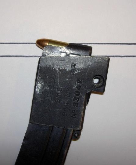

    That's because the 8 degree 'angle of presentation' (the AoP) in a STEN is incorporated into the feed lips of the Sten magazine. The mag is square on in the gun but it is the mag that presents the round at 8 degrees.
    Whereas the 8 degree AoP with a STERLING is incorporated into the actual mag housing of the gun. The rounds are square-on in the mag BUT the mag is angled in the gun at 8 degrees.
    But they both present the cartridge at 8 degrees.
    Getting complicated now or what.......
    They both present the rounds at 8 degrees as long as you put a STEN magazine in a STEN and a Sterling magazine in a Sterling.
    A Sterling magazine presents the rounds square-on in a STEN. So it doesn’t feed.
    A STEN magazine in a Sterling presents the rounds at 16 degrees. It seems like a lot compared to the Sterling magazine. But it works!
