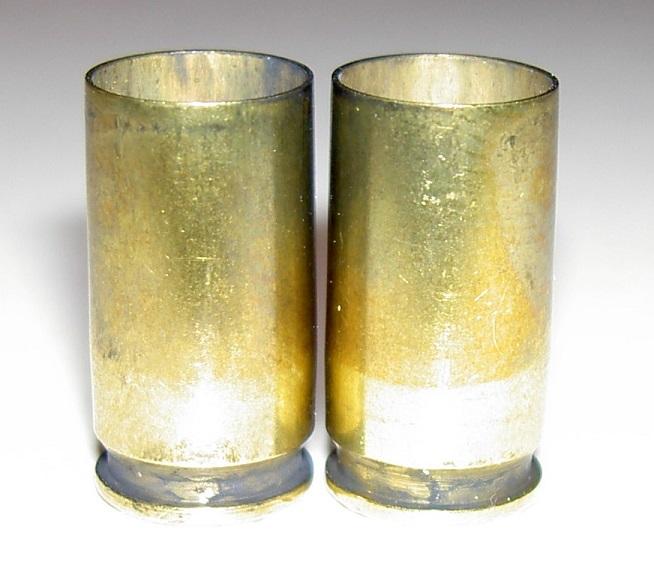

    Quote Originally Posted by tankhunter View Post
    If you have access to a 'standard' sterling SMG of any of the variants in Select fire. Instead of putting a magazine in the housing & firing ONE round.
    Insert a live cartridge in the chamber, & squeeze off that ONE round. Locate the empty case & look at it!!!!
    I just happen to have a Mk4 Sterling…… so with full safety precautions taken, I tried this.
    The one on the left was inserted into the chamber and the one on the right was magazine fed.
    It’s hard to see in the picture. The one on the left is slightly more budged than the mag fed round.
    The circumference of mag fed round bulged .004” and the inserted case .006”. So, half that and you get the amount the case wall bulged, .002” and .003”.
    Both cases are the same height and .001” shorter than unfired cases.
    Notice how the inserted case doesn’t have the clear shiny ring at the base. Any thoughts on that?

    My thoughts, without starting a fight...because I've DONE it as well many times... It works just fine. There was no perceptible difference in recoil, shot placement or cartridge appearance. The book was specific not to EVER do it, but it didn't blow anything up or destroy anything.
    Quote Originally Posted by Vincent View Post
    Complete cartridge obturation of the chambered cartridge.
    Oh. Thanks.
    Why does the mag fed case have the more shiny ring?
    Bit of guesswork there, suspect the round just settling in the chamber is not being hammered as hard as the round fully seated.
