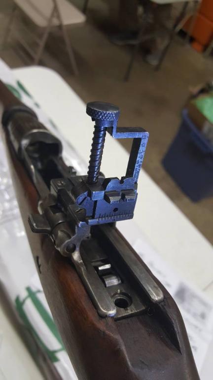

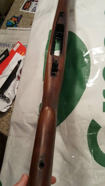

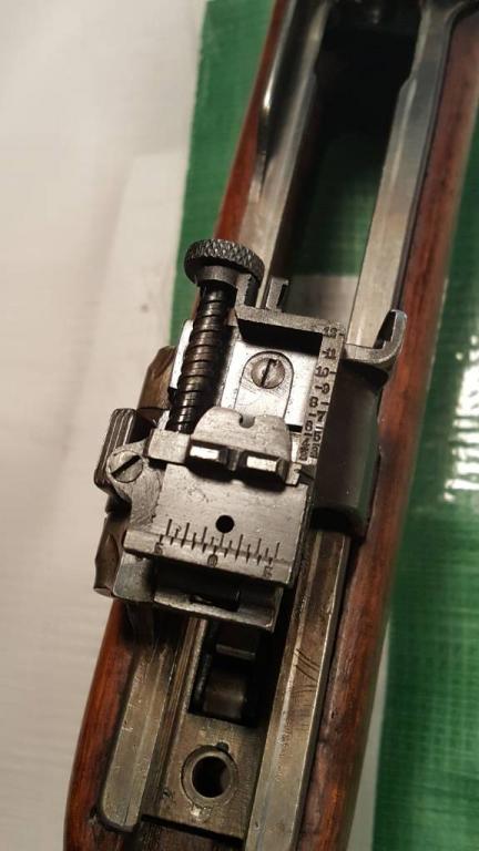

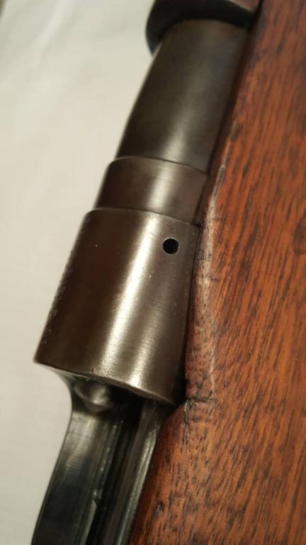

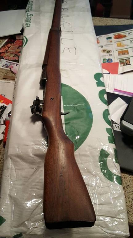

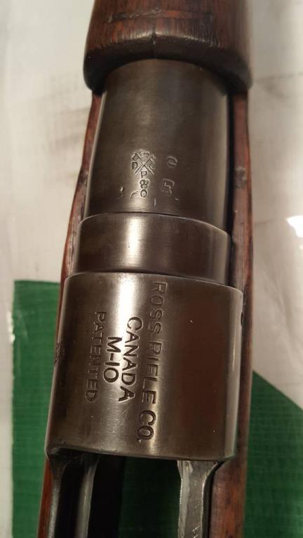

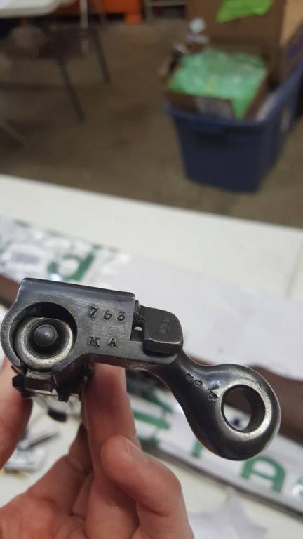

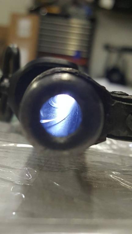

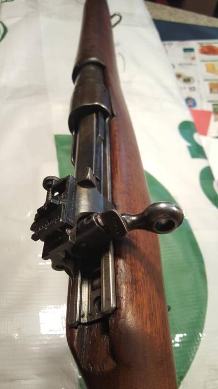

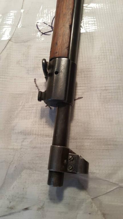

    So I have the 1910...it is pretty great. Better than I thought it would be. I really can't wait to shoot this but I will need to get it together first. It was missing the magazine, floor plate and butt plate but I acquired those. It has seen some light sandpaper but the cartouches are still very visible. Great bore.
    As mentioned, I have the big parts but need 6 screws and a rear sling swivel. I need the following screws: action screws, butt plate screws, front band screw and rear sling screw. Any help with those parts or info on this rifle would be appreciated. Thank you!

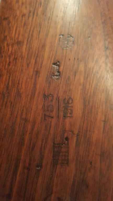

    Brit. proof marks? I would suspect that it was commercially sported in Englandicon. Note absence of markings on the right side of the thoroughly refinished stock.

    yes that is an excellent point. With Britishicon proofs it would not likely be one of the Canadianicon WWII rifles although it may appear the same. Canadian WWII ones would not have british proofs and be more likely to have CRB or PRY. I didn't notice that originally, I agree Joe is likely wrong on this one. As for the scrubbed stock I wouldn't hang my hat on that either way as I would actually be more surprised if an armoury would leave those on in a FTR come WWII of a WWI rifle.
