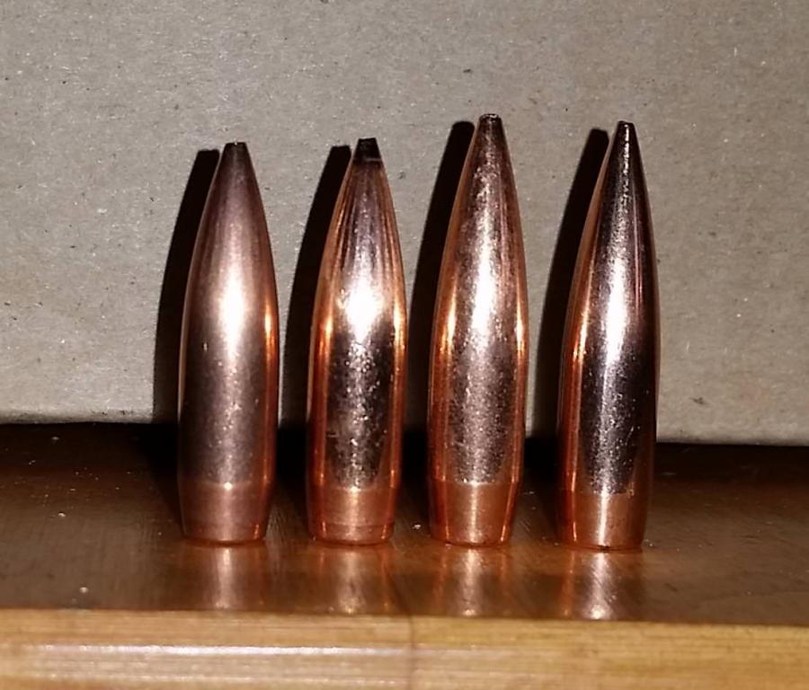

    It is possible the Nosler RDF comes closer to duplicating the GP11 bullet. As you can see, the Barnes Match Burner is closer than the Nosler CC or Sierra MK's.

    I picked up some of the Nosler 175 gr .308 RDF's. Very similar to the Barnes Match Burners
    I noticed the meplat is much smaller and more uniform than the other bullets
    Various 175 gr .308 bullets...
    Sierra MK, Nosler Custom Comp, Barnes MB, Nosler RDF
