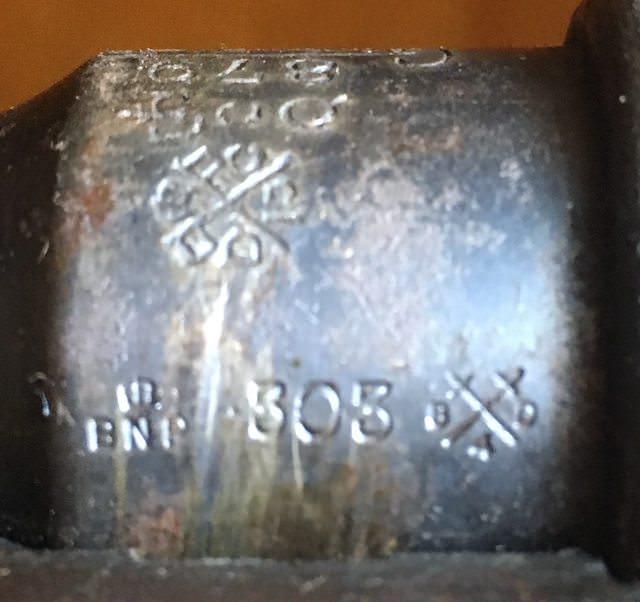

    The stamps on the left side of the receiver are all that's immediately visible. Nothing visible on the stock.

    Nice find. Barrel looks to be full length, only the wood cut back. How is the bore?
    If you carefully remove the rear hand-guard, the year of manufacture and serial number should be found there.

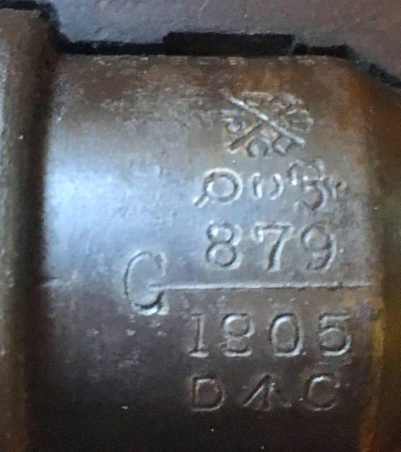

    Thanks. It turned up in a friend's shop as part of a collection.
    The barrel measures 28" inches. Minor pitting, dark in the grooves, fairly strong and bright lands, chamber clean and free of pits, crown in worn condition. It's yet to be slugged or gauged.
    Here's what's stamped under the hand guard:

    28 in. is right for a full length barrel.
    G 879 is the serial No., manufactured in 1905.
    You might be a bit surprised, the bores on Mk I and early Mk IIs are usually quite tight.
