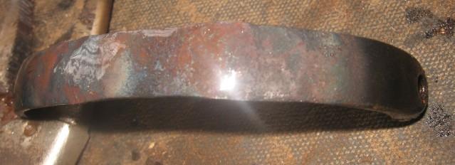

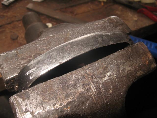

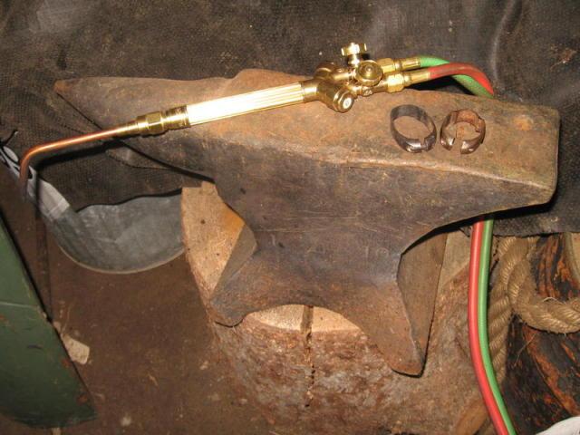

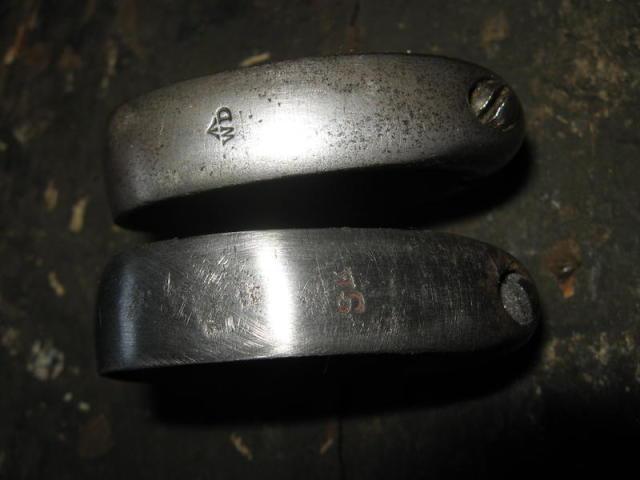

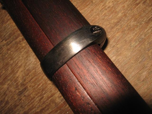

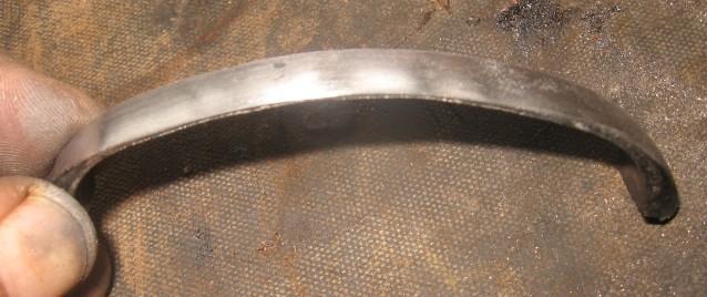

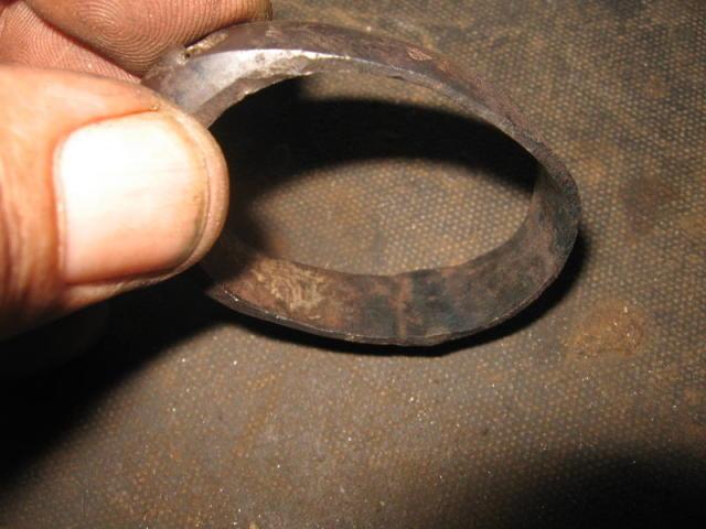

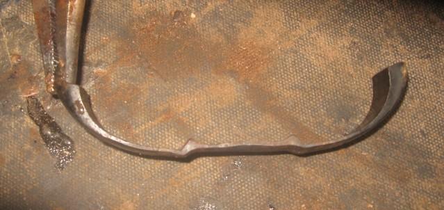

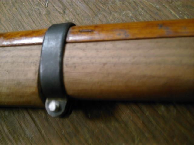

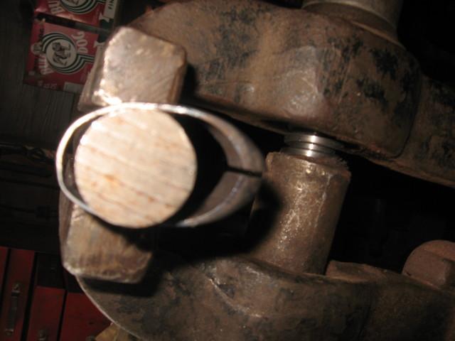

    The barrel bands that I use are actually rifle bands that has the shoulders taken out and the band reformed.
    I did try fitting one from an smle, but they are just a tad bigger than a carbine band.
    I got this one to fit only because I was making a replacement fore stock and added a little more depth to the front section. I fit it up using an original hand guard. So it can be made to work, providing that it is the non hinged style, otherwise relief has to be cut into the top of the hand guard.
    So I experimented and found that I could reforge a rifle band into a close facsimile.
    [/IMG]
    As you can see, the bottom portions of both the rifle and carbine bands are similar below the waistline. The upper portions differ in that the carbine band is designed to fit over a wooden hand guard, and the rifle barrel band is designed to fit directly over the bare barrel.
    What I tried was to reforge taking out the shoulders in the rifle band.
    The band is made out of a soft cast iron. Get it really hot, it becomes plastic and can be easily worked.
    The first thing to do is to open the band right out to get at the internal shoulders.
    [/IMG]
    Then iron out the shoulders a little bit. This also has the effect of drawing the band out a bit and making it longer.
    Attention is made to the outside and the 'crease' of the fold is taken right out.
    Once the band has been 'ironed', the clean up begins which is basically file work on the inside and out.
    I mount a chunk of solid round bar in the bench vise and use that as a mandrel over which to bend and reform the band.
    Not perfect, but close enough to be functional.
    It is a lot of work and it took me quite a few attempts to get it right. Problem now is that I am running low on rifle bands. I want them for rifle projects, they are getting hard enough to find as it is.

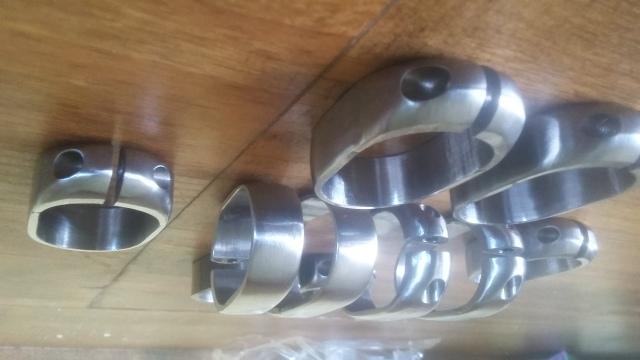

    So fabrication is the solution, I know a clever lad who does machining for me.
    I gave him an original band and he copied it. These bands are fabricated by assembling formed and machined pieces and then tig welding them into one unit. Again, a lot of work, but this will save me from sacrificing any more rifle bands.
