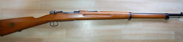

    Instead, I picked up a Carl Gustav M38, done on a 1908 M96 receiver.
