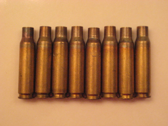

    Ok guys, here is my first attempt at neck annealing. What's the assesment? That Tempilaq is annoying though. It dries and clumps up very quickly.
    Danny
