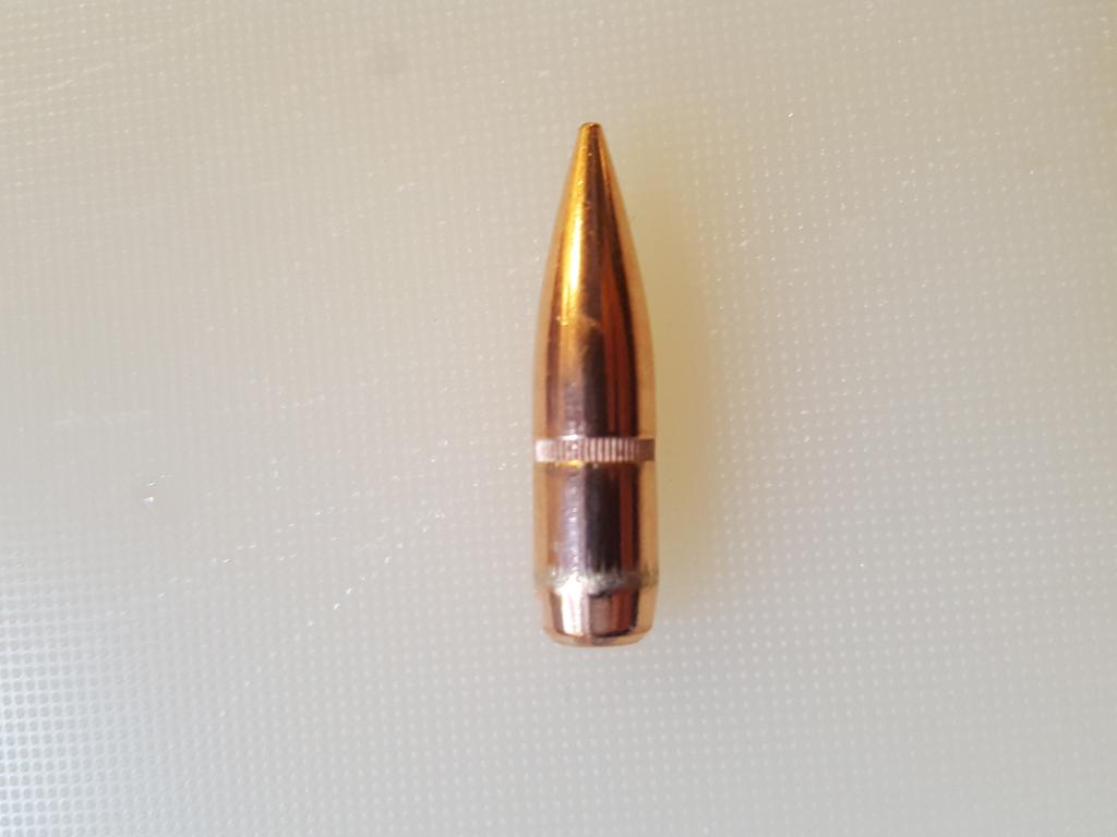

    Heres a pulled bullet. Using my 505 beam scale it weighs in at 175gr.
    Anyone know a rough BC on these?

    So thay being said, my T drum setting at 200y should at least be spot on?
