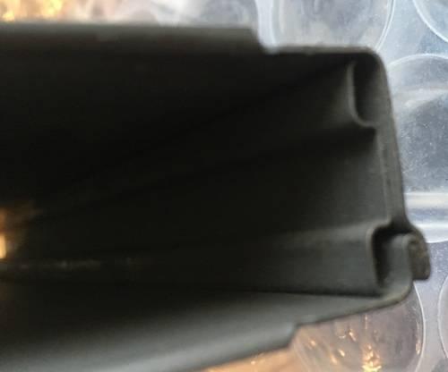

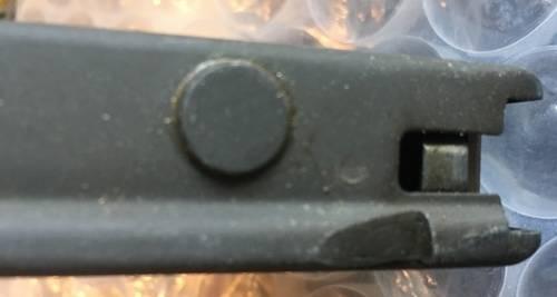

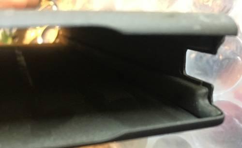

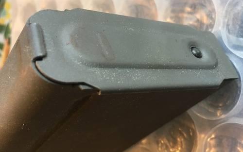

    I'm hoping the photos of the bottom plate and rear lug answer the questions.
  5. #13
  6. #14
    05-09-2025 @ 03:06 AM
    out there
    1,861
    05-14-2025
    09:21 AM
    The pictures confirm that they are C2/L2 mags which have been modified.
    The circular plate it to ensure the proper feeding angle in the C2, and the external flanges for the floor plate attachment prove the history of the mag.
    As to what it's been modified for ???
    The metric FAL and inch C1/L1 latch position is actually the same - ie, metric mags should function in an inch receiver.
    I wonder if it would match a simpler bren conversion with no machining of the front latch area ?? The height of the front latch has been lowered to a point which as the OP points out it shouldn't work in an FN FAL.
    Does the transit box have any markings?
