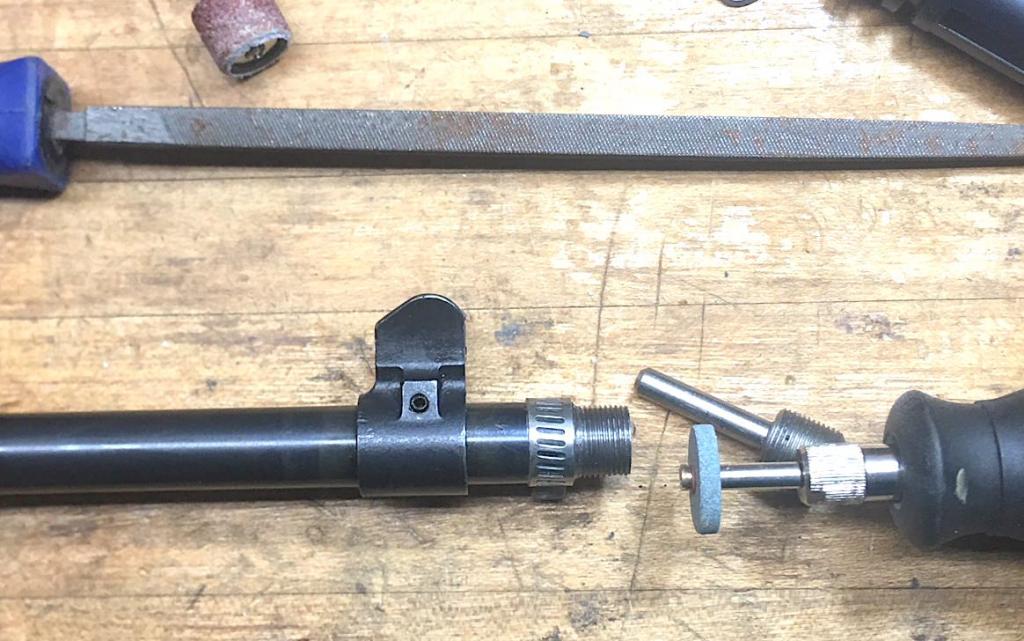

    I decided I wanted more thread. I took off the brake, and used a small clamp as a collar to keep the file or grinder from going too far up the barrel. I made an area wide enough to give slightly more than 1/2" threaded area, instead of the 1/4" I had. The clamp is a trick I used for cutting a straight line around Saiga barrel shrouds.
    I clamped it on, and started with a flat file to start reducing from .562" to .5". You do half the barrel (the clamp screw assembly prevents you from doing all the way around), then rotate the clamp 180 degrees and do the other side. After starting with the flat file, I transition to a round Dremel stone, then switched to a sanding drum with a 1/2" drum. I used a 1/2" shaft collar as a gauge. The hose clamp gave me a perfect symmetrical shoulder.
    One it was 1/2". I resumed threading. I ended up with slightly more than 1/2" as desired. No worry now about the 50,000 PSI shock wave pushing the muzzle brake off.

    Picture of hose clamp in place to use as a guide. I actually ended up with a tad over 5/16" and a tad less than 1/2" threaded for the flash hider or brake.
    1) start with flat file
    2) smooth out with Dremel stone
    3) Use emory sanding wheel to finish.

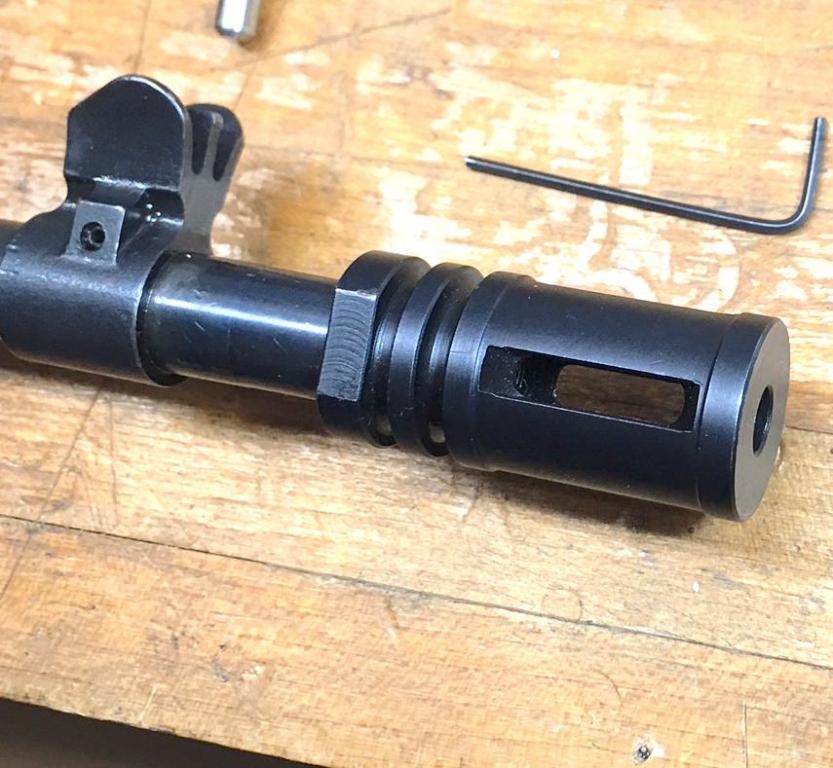

    Finished project:

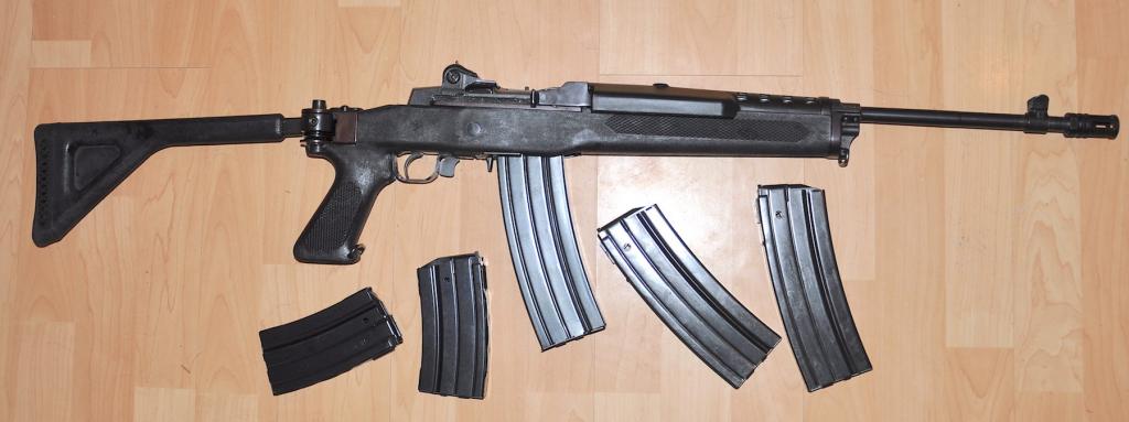

    Commiefornia legal with barrel threaded 1/2"x28 and a Wilson Combat Comp muzzle brake and my LEO marked 20 rounders from when I carried a Mini-14 as an LEO trunk weapon in the 80s and 90s.

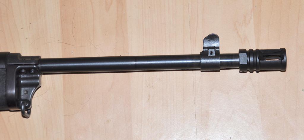

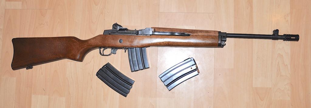

    My Oregon legal Mini-14 (pictures taken at daughter's in Medford Oregon so the California trolls don't growl). This is how it will be after I move to my house in Coos Bay area in the spring. Early Choate folding stock, and A2 flash hider. Magazine in the weapon is an old USAicon Magazines 40 rounder I kept in my Minis in the patrol car trunk.
